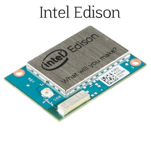

Intel Edison
The Intel Edison is a small computer-on-model made by Intel. It is a very powerful and small development system with great applications for Internet of Things devices.

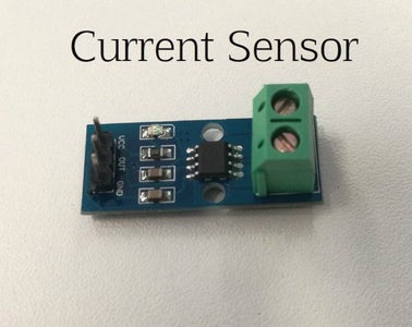

Current sensor
The current sensor we used was the ASC712. These sensors can measure up to 5A, 20A and 30A DC/AC. We chose the 20A version. It uses Hall Effect which means a current will induce a voltage that can be read by the Intel Edison. It needs to be supplied with 5V and has a sensibility of 100 mV/A. At zero current readings it should output 2,5V. For positive current readings it outputs a voltage between 2,5V and 5V and for negative currents it will output a voltage between 0 and 2,5V.

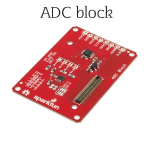

SparkFun's ADC block for Intel Edison
The SpakFun's ADC block used has a 12 bit ADC and shouldn't get more than 3,3V at its pins.

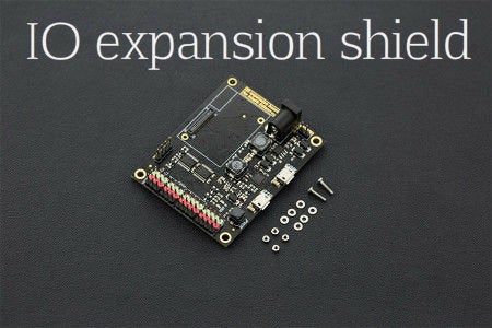

DFRobot Shield for Intel Edison
We used a IO expansion shield for Intel Edison which has 14 digital pins. We supplied it with 12V.

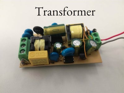

Transformer
We used a 230 AC V to 12 DC V transformer made for LED strips to supply the Intel Edison with the needed 12 V. This was also used to power our RGB LED strips.

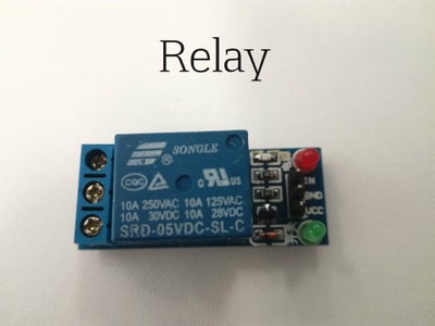

Relay
We used a small relay to be able to turn the plug on/off. The one we got can be controlled using 5V coming from the Intel Edison shield.

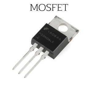

MOSFET's
We used the FQP30N06L MOSFET to be able to control each LED's colour intensity by using commutation and PWM (Pulse Width Modulation) ports. These MOSFET's are a bit overkill for this application but they were the only ones we had at hand. You could use other ones as long as they can be activated with the 5V coming from the Intel Edison Shield.

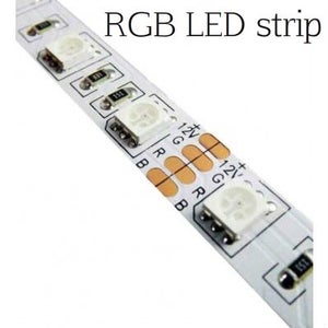

RGB LED strip
The RGB LED strip we used needed a 12V power supply.

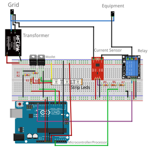

Step 2: Circuit
Here are the values of the resistors used:
- R1 = 4,7k Ohms
- R2 = 4,7k Ohms
- R3 = 220 Ohms
- R4 = 220 Ohms
- R5 = 4,7k Ohms
- R6 = 220 Ohms
- R7 = 10k Ohms
Resistors R3 and R4 were used to limit the current being drawn from the shield's pins. R1 and R2 were used as pull down resistors to ensure that when no signal was being sent the value would be 0.
The current sensor outputs at max 5V but the ADC block we used can only handle 3,3V, therefore, we used a voltage divider (with R5, R6 and R7) at Analog 0 so that the voltage would never go above 3,3V.
3,3V = 5V * (R7/(R7 + R5+ R6)) <=> R7 = 1,94 * (R5 + R6)
This also means that the sensibility will be reduced to:
Sensibility = (100 mV/A * 3,3 V)/5V = 66 mV/A
The MOSFETs are used together with PWM pins to control the intensity of the LED's lights.
