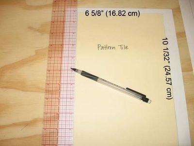

Measure the tile size. It should be 6 5/8" wide by 10 1/32" long ( 16.82 cm by 25.47 cm)
Step 3:
Using either Photoshop or a pen, paper, and ruler, create a template of a tile this size. Photoshop is easier because you can create a rectangle at the exact size and ensure that each square is the same size when you print it.

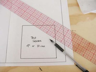

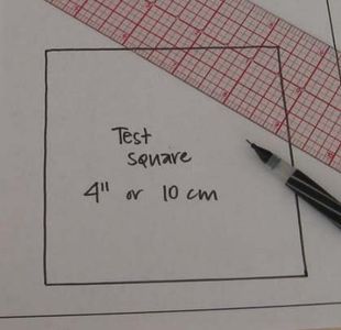

Draw a test square on one of the tiles that is 4" X 4" (10 cm X 10 cm). Be sure to mark it as the test square and what measurements it should be.

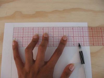

Finish all pieces with necessary seam allowances, using tools like the oh-so-handy clear, plastic ruler and the french curve.

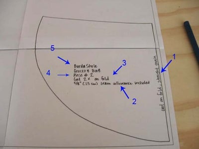

Make all necessary markings: (1) Be sure to mark the grainline, and any where the piece is to be cut on the fold. (2) Mark whether or not the Seam Allowance is included, and what the seam allowance is. (3) Mark how many of this piece is to be cut. (4) If you have given the piece a number, mark that. (5) Label it with your name (if you're the designer- you should give yourself credit!) and the name of the pattern.

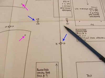

Like the BurdaStyle Print-at-Home PDFs, mark points where the pattern tiles should join together (Blue arrows). If your pieces include the seam allowance but don't show the sewing lines, it might help to mark the points where pieces will join (pink arrows).

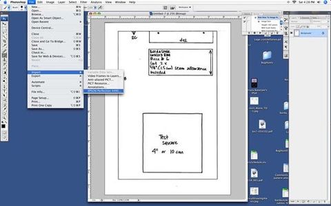

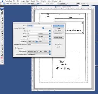

Scan the tile with the Test Square on it by importing it into Photoshop at 300 dpi, in Black & white, for Print Quality.
Step 14:

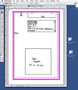

Select 1/4" (6 mm) around the entire tile, and COPY.
Step 15:
Create a new documentL U.S. Letter size or A4 in CMYK Color. Paste image.
Step 16:

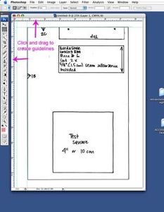

To make sure the tile was scanned straight, drag guidelines by clicking in the rulers on the side, and align with tile sides. If it is not straight, Click Edit, Transform, and Rotate and rotate the tile until it is straight.
Step 17:

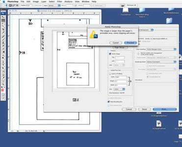

Send to print. Center Image- do not scale/fit to print. If prompted with a "some areas will be clipped. . ." message, press proceed.

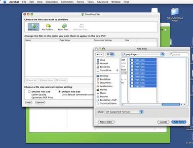

Open Adobe Acrobat and choose the option to create a PDF from multiple files.
Step 20:
Select all pages of tiles, in order, as the PDF will be made according the order the files are added. Save PDF and print a test.
