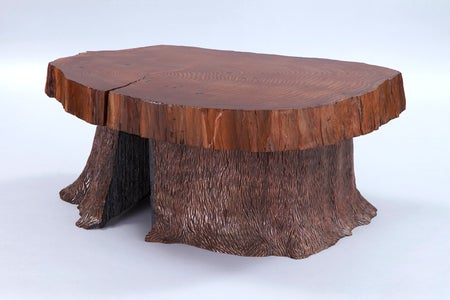

It is easy to create a realistic copper finish using just water based paints. I got a fabulous result with this method on the carved base of this slab coffee table. I think it looks better if the surface has a bit of texture, but it will work on a flat surface, too.
The video is a quick overview of the entire build process for that table and it includes information on how I did the copper finish, too!

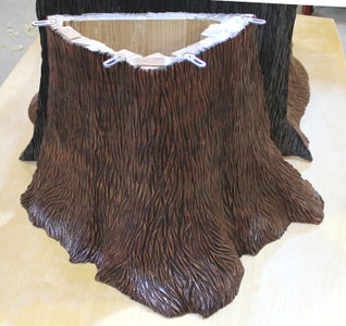

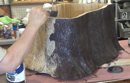

Step 1: Apply a Base Coat
The first step is to apply a deep brown base coat.
I used Rustoleum's Satin Espresso, but any deep brown paint that isn't too glossy will do

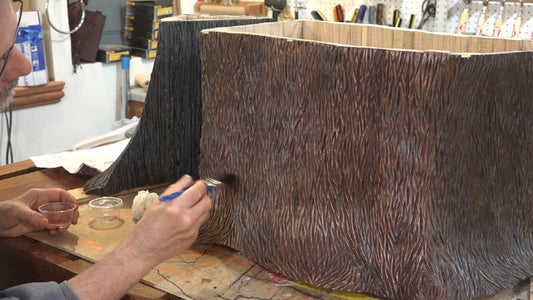

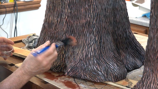

Step 2: Dry Brush a Coat of Copper Paint
The next step is to dry brush a coat of copper colored accent paint.
Use high quality paint for the best result. I like "Golden” brand acrylics because their colors are so rich and realistic looking. They have two shades of copper paint, Iridescent Copper is more of a reddish color and Iridescent Copper Light is more of a gold colored copper.
Start with the Iridescent Copper (more reddish color)

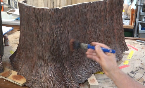

Dry brushing is a technique for applying very thin, light coats of color to a project and it is very easy to do. The idea is to have such a small amount of paint on your brush that it is almost "dry".
- Dip just the tips of your brush into the paint
- Dab your brush onto a piece of paper to remove the excess paint before you apply it to your project
- Apply the accent color by moving your brush lightly across the surface of your project .
When you are done with this step your project should have a bright copper tone to it. If this is the look you were hoping for then you are done!
If you want a more subdued look then move on to the next step.

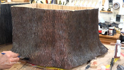

Step 3: Tone It Down a Bit!
If you want a more subtle look then dry brush a VERY thin coat of the Iridescent Copper Light over the entire surface. Another way to tone it back is to dry brush a tiny bit the brown over the top.
Feel free to have some fun with this and experiment a little!
