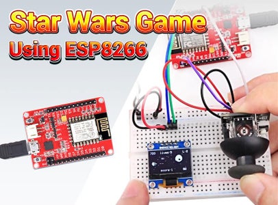

Step 1: Circuit Connection
To simplify connectivity and operation, we are using a breadboard for connection. The wiring process is straightforward, requiring only 4 wires to connect each module.
Due to misalignment between the joystick pins and breadboard holes, additional wires may be necessary for us to smooth our project.
Note that the default I2C pins of ESP8266 are GPIO4 and GPIO5(SDA, SCL). And the joystick's X or Y output pin must be linked to the ESP8266's input/output pins supporting analog, namely A0 or A1. Failure to do so may result in getting the wrong numbers of X or Y.
