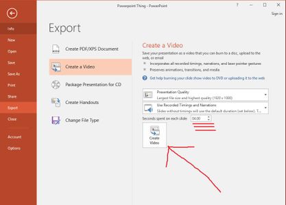

Step 7: Select "Create a Video"
You then want to select “Create a video”. As a side note, you can customize your presentation further by possibly changing the time you want for each slide or increasing or decreasing the quality of the video.
Step 8: Save the Filename/location
Once you have selected “Create a Video”, your folder will open up, asking you where you wish to save your information and what filename/type you want to use. (We recommend using the MPEG-4 filetype, as it's current and playable by the vast majority of programs and devices). Click the appropriate location you wish to save it and click “Save”.
Step 9: Finished!
Congratulations, you've done it! Your video file should now be saved in the location you chose. You can email it, copy it to a CD or USB drive, or upload to a website!
