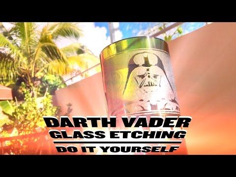

Introduction: Tools Needed
- Glass Bottle
- Dust Mask
- Safety Googles
- Masking Tape
- Sandpaper (150)
- Dremel Diamond Point (7144)
- Dremel Power Tool
- G2 Bottle Cutter (to mark the bottle)
Step 1: Marking the Cutting Height
Using the G2 Bottle Cutter, mark the bottle in the position where you want to cut it. Just apply a little pressure to the bottle against the Cutter. From this step forward, it's recommended to use the Safety Googles!!!
Step 2: How to Separate the Bottle
[Option A]
Alternate Hot and Cold water. Try to just splash with water the cutting line!
[Option B]
Using the Dremel Thin Disk, cut thru the line. Be patient, just apply light pressure!... From this step forward is recommended to use the Dust Mask!!!
Step 3: Smooth the Glass Edges
Using a 150 sandpaper, rub off the glass border to even the surface and continue until it is smooth to the touch!
Step 4: Surface Preparation
Cover with masking tape the area of the glass where you will be engraving the art
Step 5: View the Final 4 Steps on the DIY Video Below to Finish the Tutorial
Click the thumbnail above or HEREto view in detail the final 4 steps In the DIY video! If you liked this tutorial, please press FAVORITED in Instructables and LIKE on the YouTube Video... Thanks for the support!...
