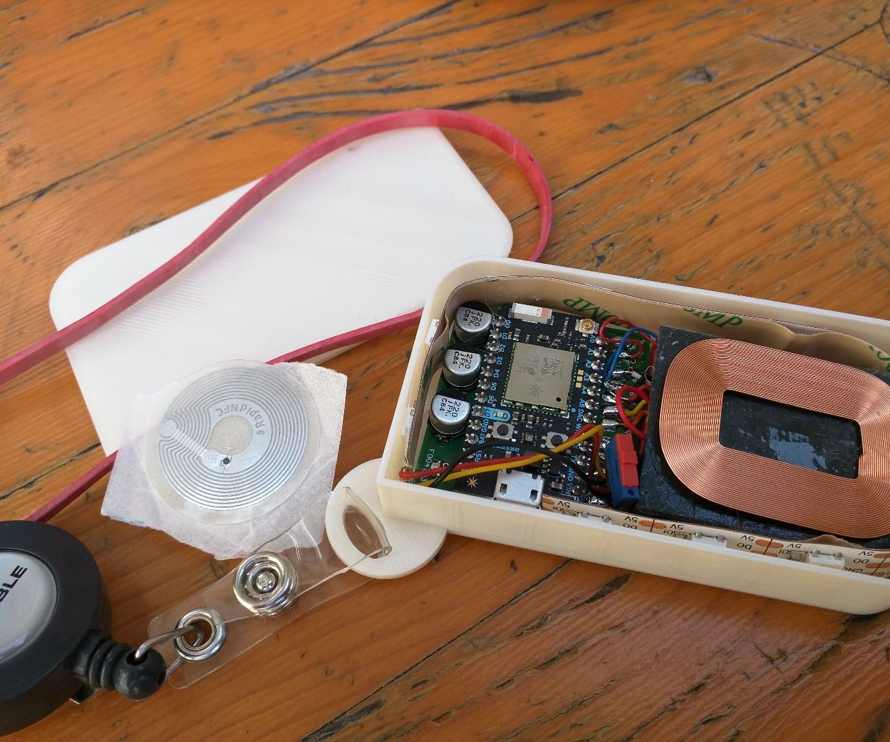

Step 2: Setup the Particle Photon
If you have not yet done so, create an account at particle.io and work through the getting started tutorial there. At the end of this short, maybe 10min process, you will have a connected Particle Photon and the web build environment should be ready for some fresh firmware code that you can push to the device.
It is now time to launch the web IDE, paste code from particle_firmware.c into the web editor and flash the Particle Photon. The firmware is quite simple, it sets up the button input pin and the LED output pin. The loop() function is iterated over and over again and will check if the button was pressed, then light up twice and start to check for a new button press. Each time, it will send out a launch event via Spark.publish("launch") to the Particle cloud. At this point we would not know where to send the webhooks to (webhooks are web requests sent in response to these events). So we leave that webhook step for later on.
Don't forget to select the right Particle Photon and hit the flash button to save the firmware to the device!
At this point, we now wire the arcade button to the Particle Photon pins.

Step 3: Wire the Particle Photon to the Button and Button LED
Now, let's solder and connect some wires, the fun part. For the wires, I used some female jumper cables, cut them in half and soldered one end to the button parts. You need to make these connections:
- D0 on Particle Photon, the Button Input Pin, is connected to the button pins as shown in the picture
- The button pin that signals the high/low state is connected to GND of the Particle. As the LED wiring requires GND, too (here GND is on the left pin for the button pic) the resistor is connected to that GND pin and we can save one cable therefore.
- The GND pin of the LED is connected to GND on the Particle Photon
- D1 is connected to the power pin of the button LED, here the pin on the right.
- 3V3 is connected to the second button PIN, e.g. the top pin when the button is seen from the front. When the button is pressed, power is flowing from the top button pin to the signal pin at the very top of the button, thereby resulting in a HIGH signal.
If you are a bit unsure about the proper button wiring (there are different ways to wire a button, too), have a look at this image from the Arduino website. It shows the wiring of a typically LOW button, that goes HIGH when pressed, just like in our case.
One optional step, that is a bit tricky, is to take apart the button LED and swap the LED/resistor combination. By default, the LED within the button is wired to a resistor suitable for 12V. As we do only have 3V3 volts, turning the D1 LED PIN on/off is almost invisible. So try turning the switch of the button slightly, until it is released from the button. Then remove the top part, that contains the LED. Carefully take off the LED by straightening the LED pins, you will then see that one leg has a resistor directly soldered to it. Carefully desolder the resistor and replace it with the lower value resistor, e.g. the 47Ohm resistor. Put it all together again.
