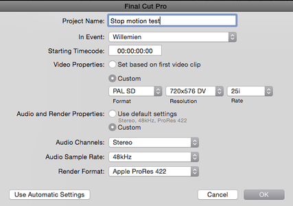

Step 1: Create a New Project

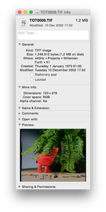

Choose File - New - Project... from the menu. In the dialog that appears (see image) enter the correct dimensions of your still frames. In this example, all the still frames were PAL SD 720 x 576 frames. Your still images might be of a different resolution. When in doubt, select one of your frames in the OSX Finder and hit Command I (for Information). In the dialog that opens, you can see the resolution of the image.

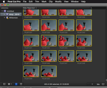

Step 3: Select All Images in the Browser
Select all images in the browser (Command A). They will all be yellow now, as you can see in the screen shot in this step.

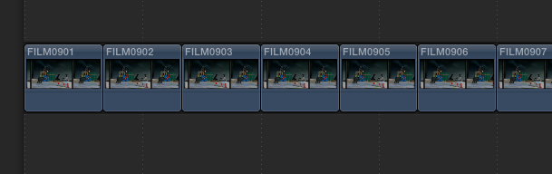

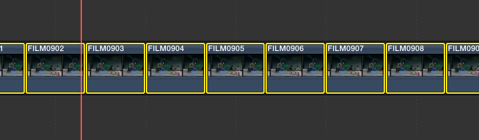

Step 5: Select the Images As They Are Inserted Into the Timeline
Click once in the timeline, where your still images are now visible and select them all, simply by pressing Command A.
As you can see in the images, all the frames in the timeline now also get a yellow outline. There is no reason to zoom in or out. The problem is that, as a default, all still frame images are 2 seconds long. So this would result in a very lengthy movie that doesn't animate as desired. So we need to make all the images exactly 1 frame long in one fell swoop. All will be clear in the next steps!

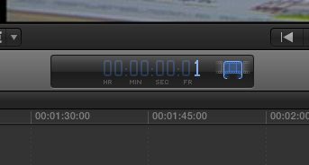

Step 6: Set the Length of Every Image to Exactly 1 Frame
With all the images selected in the timeline press in exactly the following order:
- Control D
- 1
- Enter
After a short while, you will end up with the images all squashed together in the timeline, where every image lasts exactly 1 frame.

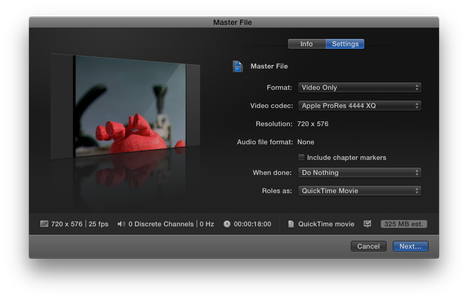

Step 7: Render Your Movie
All these 1 frame images edited together are rather unwieldy to work with, so it might be a good idea to render the sequence out to a new file. If this stop motion sequence is part of a project that still needs editing, it's a wise choice to choose an in-between video format such as MPEG IMX (50 Mbps) or Apple ProRes 4444 XQ. Simply render this file out using the menu command
File - Share - Master file (default)...
In the dialog that opens, be sure to set Format to Video Only, as there is no audio in this stop motion sequence.
