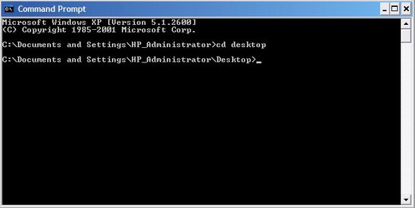

Step 3: Change Directory
Once in command prompt, type
cd desktop
That will change the directory command prompt is in, to the desktop.
