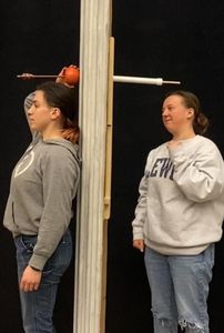

This project involves creating a special effect where an arrow emerges from a piece of scenery and goes through an apple, as if the arrow has struck the apple. The mechanism consists of a hidden connection of two different-sized PVC pipes. A larger PVC pipe is placed on the backside of the connection, concealing the majority of the arrow and the smaller PVC pipe will be hidden in the facing of the scenery. The arrow will be placed in the PVC mechanism, with a stopper added to the back of the arrow to allow it to go through the large PVC pipe but prevent it from going into the smaller PVC pipe, allowing it to emerge from the scenery but not exit through the scenery.
A pressure cap will be attached to the larger PVC pipe with a hole for a dowel to go through. The dowel will push the arrow forward, causing it to emerge through the scenery. The apple will have a PVC pipe running through its middle, sized to match the smaller PVC pipe in the mechanism. A piece of felt will be placed at the top of the apple to allow the apple to be used as a hand prop throughout the scene before being pierced. On the bottom of the apple, rare earth magnets will be placed, which align with magnets on the scenery that will line the hole in the apple with the hole in the scenery. When the dowel pushes the arrow forward, it will emerge from the scenery and pass through the apple, creating the illusion of the arrow hitting the apple.

  10. While the epoxy is drying, take the arrow and wrap masking tape around the back of the arrow so the back of the arrow is ½” tall, then insert it into the connected PVC pipe.
  11. Guide the arrow so the tip sits inside the ½” PVC pipe.
  12. Once the arrow is positioned within the connected PVC pipes, take the ¾” PVC pressure cap and drill a ½” hole in the center.
  13. Attach the pressure cap to the end of the ¾” PVC pipe.
  14. Insert a ¼” dowel into the hole in the pressure cap and use it to push the arrow forward.
  15. Next, take two rare earth magnets and place them on top of the magnets on the artificial apple.
  16. Push the arrow out of the PVC pipes by about 6”.
  17. Place the apple on the arrow.
  18. Apply epoxy to the backside of two new rare earth magnets (the side not facing the apple magnets) and position the apple on the scenery. Ensure the PVC pipe in the scenery aligns with the PVC pipe in the apple.
  19. If possible, lean the scenery on its side during this step, as it will make it easier. Otherwise, you will need to hold the apple in place while the epoxy dries.
  20. Once the epoxy has dried, you should be able to easily remove the apple, and the new rare earth magnets will stick to the scenery.
Now your mechanism is ready!
