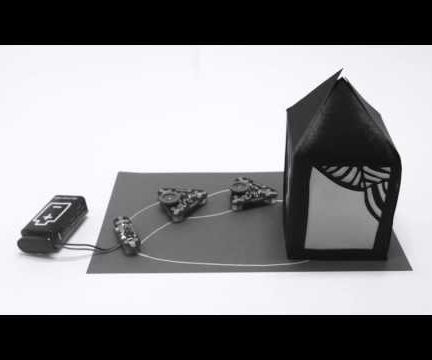

Step 10: Bonus: Circuit Scribe Variation
Our original prototype of the light following flower bot was created with the Circuit Scribe Maker Kit components. We used two of the 3-terminal light sensor modules instead of the photo sensors and 1 k-ohm resistors.
Materials needed (in addition to original materials):
- Circuit Scribe pen
- Steel sheet or other magnetic surface
- Circuit Stencil or paper circuit template (provided below)
- Card stock
- 2x light sensor modules
- 4x Arduino connection cables
Instructions:
- Program the Arduino UNO the same way that you would for the breadboard version of the project.
- Print out a Circuit Scribe template from the 123D Circuits example below and trace it with Circuit Scribe ink, or draw the pattern free-hand using your Circuit Stencil as a guide for module foot spacing.
- Place the paper circuit on the Steel Sheet from the Circuit Scribe kit, or on another magnetic surface.
- Place the two light sensors, as shown.
- Tape the servo motor + paper flower in between the two light sensor modules.
- Finally, break out the A1, GND, +5V, and A0 pins on the Arduino (in that order) using the magnetic connection cables, and connect the magnets to the paper circuit.
Once everything is constructed, you can go through the same sensor calibration and troubleshooting steps (Steps 7 & 8) that you used for the breadboard version of the circuit!
