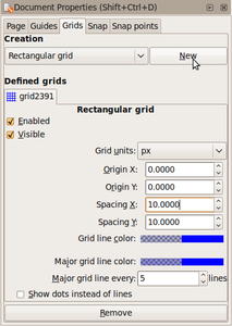

Next, you'll want to set up the grid. In older versions of Inkscape, there was only one grid possble. In newer versions, you'll need to create a new grid. Change the grid spacing so that these values divide evenly into the values of the document width & hegiht.
Generally, it's a good idea to work from a large image and then scale down as necessary. Because this is vector art, size techincally does not matter, but practically speaking, it will be easier conceptually with larger numbers. In this tutorial, I used a 500x500px image, and my grid is at 10px intervals.

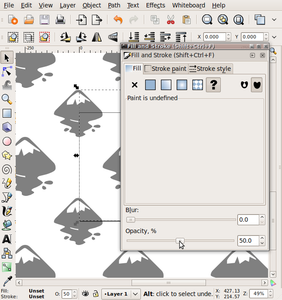

As an optional step, select the background square (Ctrl-click) and set the fill color to none (ie- transparent) or whatever color you want to have the background. ([Object -> Fill and stroke])
I also decreased the opacity of the group as a whole (select by regular click) so that the pattern can be in the background and not be intrusive.
Finally, the important step of exporting. Open up the exporting window ([File -> Export bitmap]). Click the "Page" button. This will export just the parts of the document that fall within the page boundaries -- that is, inside the square of the "original".
Change the exported bitmap size if you want, and then click "Export".
