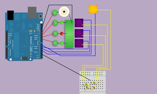

Mix up your electro dough and create your doughy scene. The electro dough recipe can be found here http://tinyurl.com/muy8uxf. The LEDs that accompany our buttons have polarity and will need separated positive and nevagtive legs so you will need both conductive and insulating dough to complete the circuit.
The electro dough works like the breadboard that came with your Arduino but the dough has some resistance in it already so you wont need any resistors with your LED.
Step 3:
Connect your LED to arduino pins 9,10,11, and connect your buzzer to pin 12 (remember we don’t need resistors with the dough)
The capacitive touch sensing on the arduino works by detecting changes in a current flowing through our piece of dough. We will be using four separate capacitive buttons but they will all share the same input, pin 2. Run a jumper wire from pin 2 to your breadboard and run your four 1M resistors from there to new rows and connect to the dough with another jumper wire. Once you have that done, then run a jumper wire from each button back to pins 4, 5, 6 and 7.
