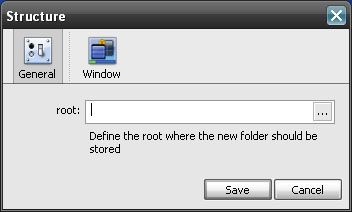

Set the preferences of a widget by right-clicking on any part of it, and click on preferences.
Change the preferences of Structure to the following:
root: Navigate to your widget folder. (Located in 'My Documents' on Windows)
Now you can click on the widget and a dialog box will pop up, asking you for the name of the widget.

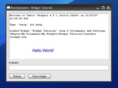

Double-Click on the kon file and your widget will load. Congratulations! You have created your first widget. But we're not done coding yet. Your probably thinking, "That's all?", right? Continue to step 5 to add some function to your widget.
