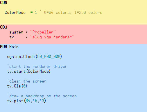

Open the Propeller Tool and type up the following program:
(As you type CON, OBJ, and PUB the background colors will change.)
Programming Notes for TV users:
If you are using the TV version of SLUG, change the tv.start(ColorMode) to simply tv.start.
Also change tv : "slug_vga_renderer" to tv : "slug_tv_renderer".
Programming Notes for VGA users:
If you are using the a non VGAplus256 circuit or standard Parallax VGA circuit,
use the original SLUG driver (second link in SLUG in chapter 1).  Change tv.start(ColorMode) to tv.start.
Once everything is typed in, save the program into the same folder you extracted the SLUG archive to, then press F10 to send the program to your Propeller.   If everything was typed correctly, you should have a single block in the center of the screen.
Let's break the program down into understandable parts...
I'll got into depth about how each section works in the next chapter, but for now we'll just look quickly at what you've just entered.
CON is the configuration section of our program.   We've set the variable ColorMode to select between 256 Color VGA Mode (1) and 64 Color VGA Mode (2).  Settings which are established in the CON section of a program remain constant throughout the program.
OBJ is the object section of our program.   Here we can call on ready-to-use programs (code/objects) and include them for use in our program.  We've called in the "Propeller" object and declared it's name to be system.   We've also called in the "slug_vga_rendering" object and declared it's name tv.
PUB defines a "public" program function.  In this case, we named this PUB, "Main".   This has become to the start of our actual program after we defined the "constant" variables in CON, and invited some additional code in OBJect.
All that work and we haven't done anything interesting yet!   Wait for it!  we're into the good stuff now!
system.Clock(80_000_000)  defines the speed this program will run on our Propeller board.   Most Propeller configurations run at a speed of 80Mhz, designated by system.Clock each time we run the program.   This is one of those commands I'll simply ask you to take my word for right now.
tv.start(ColorMode) starts the SLUG rendering code using the setting provided in CON.
tv.Cls(0) clears the screen using the color 0 (black).
tv.plot(64,45,43) plots a single block on the screen at location 64,45  (x,y locations) and in color 43.
Things to try!!  Learn by experimentation!
1)
Remember the driver is 128 blocks across the screen.   64 is in the middle between the right and side sides of the screen.
There are also 96 blocks between the top of the screen and the bottom of the screen.  45 is again in the middle.
Try changing these numbers and re-run the program using F10.
2)
Depending on which rendering driver you are using (TV, VGA-64, or VGA-256) you have access to 64 or 255 colors.
Try changing the 0 in the tv.Cls line or the 43 in the tv.plot line to change colors.
3)
Try adding another tv.plot command right below the one you already have in the program.   Change the x,y and colors.
