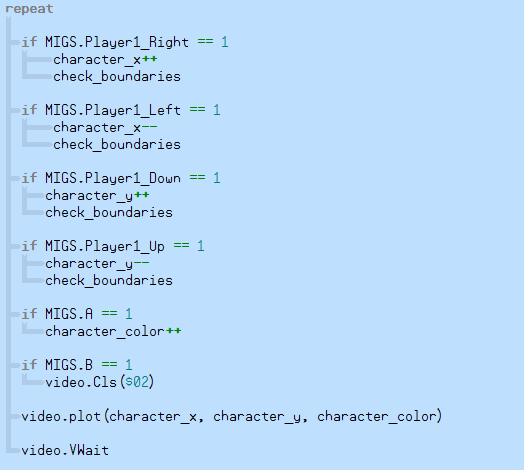

Step 7: Your First Program: ACTION!
Everything we have done up to this point has been preparation for our program.
Finally, it's time to make our little program actually DO something!
Insert another blank line below what you have typed and add the following lines:
Note! Indentation is very important. Use spaces and the Tab key to duplicate what you see here. I'll explain after you are finished.
Since this is the core of our program, we don't want it to stop, so the first thing we do is setup a repeat loop.
The repeat command causes everything which is indented below it to loop over and over again until we act on the program by either programming a way to break out of the loop, or stop the program by powering off the Propeller.
You'll notice that as you typed each line (indented below repeat) it drew a straight line down the entire left side. This line helps us see what lines are included in the loop. Had we not indented the last line, video.VWait it would not have been included.
Let's take a look at the next three lines of code:
An if statement is a condition check. The statement if MIGS.Player1_Right == 1 checks to see if the right button is pressed on the game controller. When the button isn't being pressed it usually reports a 0. When the button is being pressed a 1 is seen by the if condition check. Notice how the next two lines are indented again beyond the if statement? This means that if the right button is pressed on the controller, the character_x++ and check_boundaries command are executed.
So what happened when the the character_x++ is executed?
The ++ added 1 to it's existing value contained in the character_x variable box we created in the VAR section of the program.
When we started the program we put the number 45 in that box. Pressing the right button once makes it 46.
Guess what character_x-- does in the section if MIGS.Player1_Left == 1?
That's right! When the left button is pressed, -- subtracts 1 from the value contained in the character_x variable box.
I'll bet by now if you can tell exactly what MIGS_Player1_Down & MIGS_Player1_Up do. You probably can even guess what is happening when MIGS.A (button/keyboard A) and MIGS.B (button/keyboard B) are pressed.
How are you doing so far? It might a lot to take in, but we're almost to the ACTION part of our program.
Up to this point we have been reading the game controller and adjusting variables depending on which button is pressed.
I'm going to ask you to ignore the check_boundaries command for a few minutes. We'll come back to it.
It's time to do something with all this information we've collected.
video.plot(character_x,character_y,character_color) probably looks very familiar Issuing number to the plot command we were able to place boxes on the screen in the last chapter. This time we will plot based on our variables each time the loop repeats. (over and over again!) When these numbers change, the plot location plots a new location on the screen.
video.VWait provides the video driver a slight delay in our repeat loop allowing the video driver object to catch up with our program. Don't omit it.
