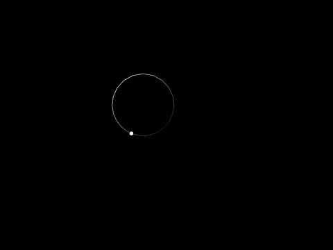

open this URL to run the code using google colab
result of animation
