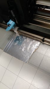

Step 2: Step 2: Cut!
We had to experiment with the cut depth and trace (conductive path) width, but the Silhouette was happy to cut through the foil for us. We even dialed it in so that the cut didn't slice all the way through the backing material so we could peel it up easily.
