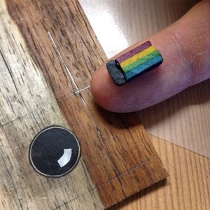

My first inlay piece is round, so I used a plug cutter for the centre part, then I wrapped it in purfling for the other colours. Purflings are the decorative veneer strips that surround guitars and violins. I carefully use CA glue, otherwise known as superglue, to stick them together.
To make the hole for the first bit of inlay to sit it, tack the components together with a single small dot of CA glue, then carefully trace the perimeter with a razor knife. I trace very gently at first because the grain, or fibres of the wood can often pull the blade off course. Carefully snap the pieces apart, then deepen the scribed line a little more with your knife.
Using your coping saw, cut very close to the line while supporting the piece in the notch of the V-board. Then use small files to get the shape just right until the parts fit.
Glue the components together with CA glue. I often use a spray product called accelerator to speed up the curing process. Sand the surfaces flush with 220 grit paper.
