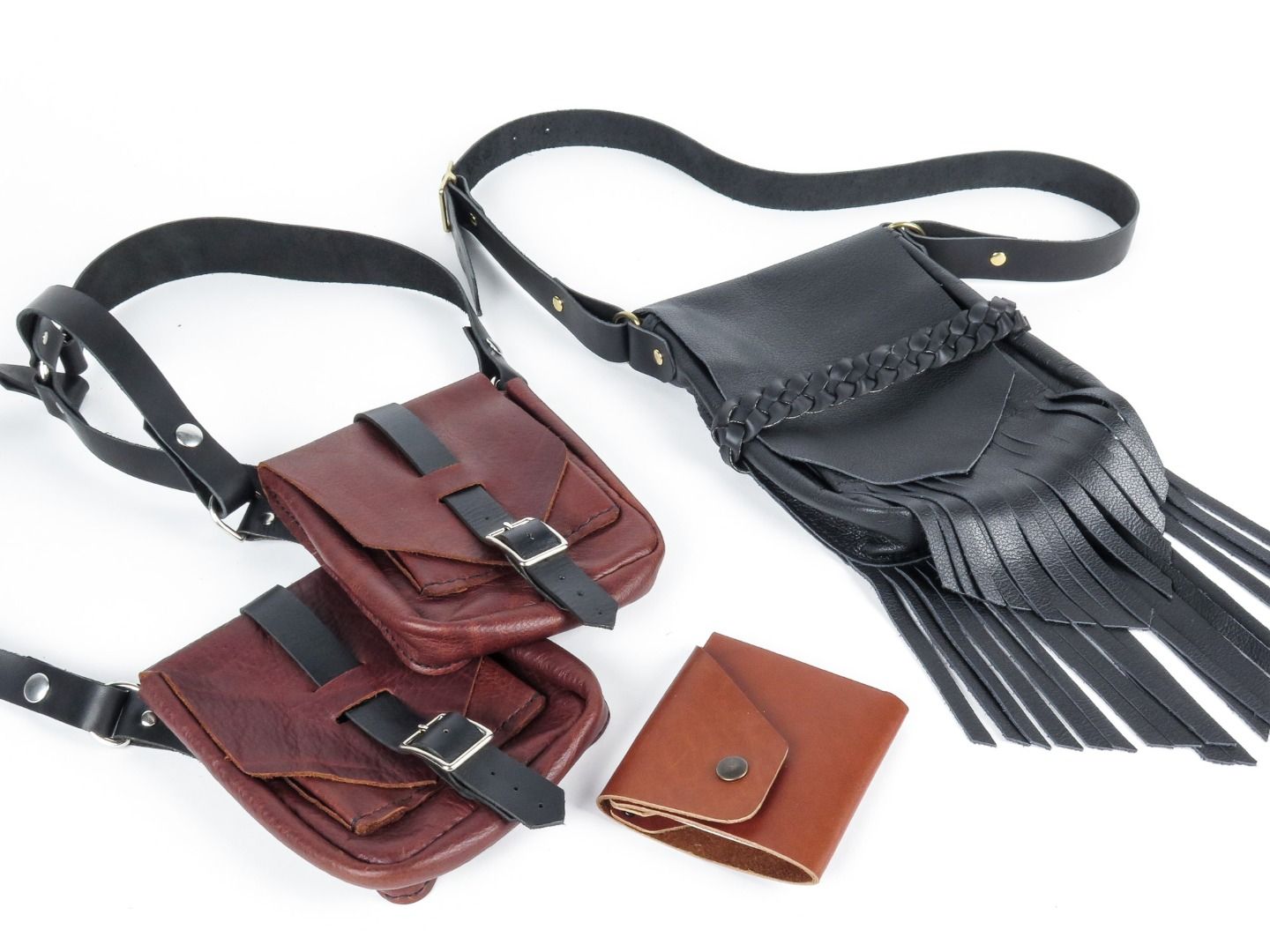

Step 2: Single Layer Shoulder Straps

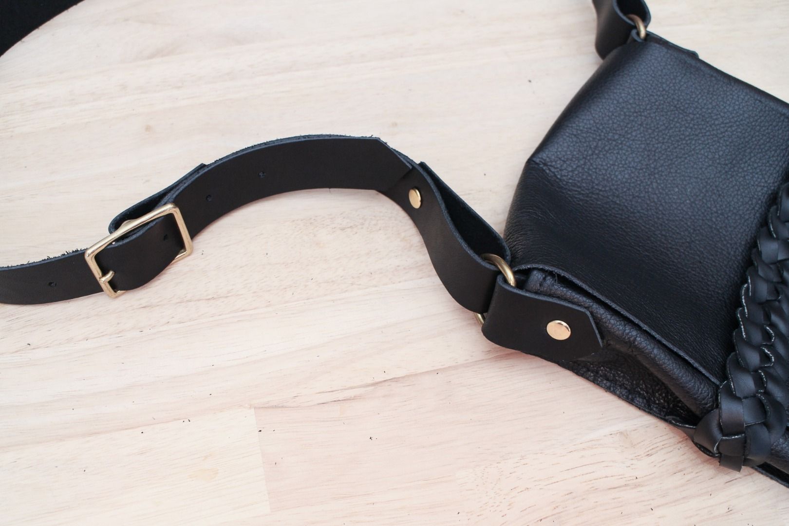

When you want to create a strap out of single layer of leather, you need to use leather that is thick and strong enough that it won't stretch or break. You should choose a leather that is at least 6-9 oz and not stretchy. A lot of straps are made from thick veg tanned leather, but in the chrome tanned leather world, a thick latigo, or even a stiff stamped leather can be a good choice for a single layer strap.
To create a shoulder strap for a bag, first decide what style of strap you want to create. Do you want it to be adjustable or fixed length? Buckle, snap or rivet attachment? It's usually good to maintain continuity between the style of your bag and the style of the strap. Shoulder straps should be between 5/8" and 1 1/2" wide, depending on the size and proportions of the bag. Straps with a continuous width of more than 1 1/2" will tend to fall off your shoulder.
Straps should attach securely to your bag in at least two places. In this case you need to create a strap with ends that will fit through the 1" D rings we've already attached to our larger bag (or the 3/4" D rings on our smaller bag). To get the length of the strap for a bag, you can look at bags you already wear and measure their strap length, or just take a cloth measuring tape and drape it over your shoulder to find the right length. A strap length that allows the bag to sit around the hip is a good standard length. In my case this is 40".

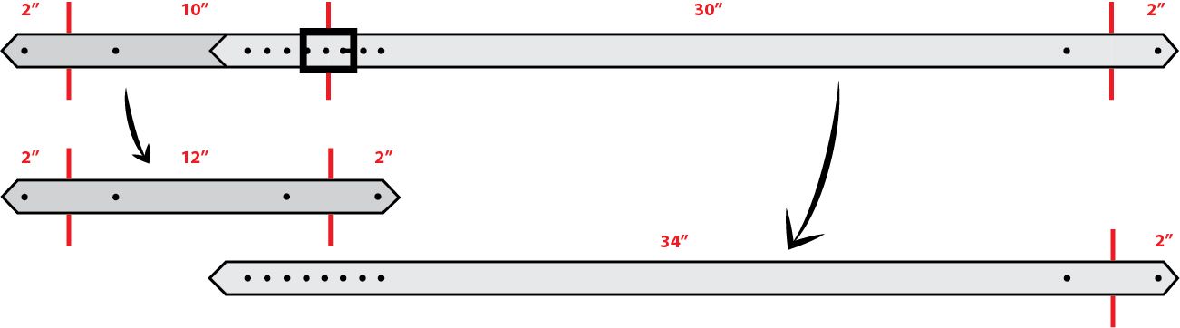

To make a strap with an adjustable length, I created a strap with a consistent 1" width, and added a buckle on one side. It's best to put the buckle near one end of the strap because if it ends up sitting on your shoulder or back it will be uncomfortable. In order to add the buckle, the strap needs to be two separate parts. I decided to put my buckle 10" up the strap, so the short end of the strap is 10" + 2" on each end for attachment, 14" total. The long end of the strap is 30" + 4" for buckle adjustment on one end, and 2" for attachment on the other end, 36" total.
I used a cutting wheel and a metal ruler to cut long strap pieces and then trimmed them to the right length.
Punch some holes in one end of the long strap, I punched 8 holes spaced 1" apart, then attach a 1" center bar buckle to one end of the short strap.
Now attach the other end of the short and long straps to the D rings on the bag. You could rivet them on for a permanent attachment, or decide to add snaps so they will be removable. You could also use grommets here and attach the bag with swivel snaps. There are a lot of options.
Think about which side of your body you are more likely to wear a purse, for me this is the right side, so I attached the long strap to that side of the purse so the buckle will face backward when I have the bag over my shoulder.

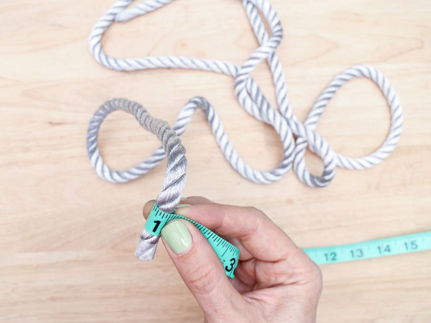

This kind of strap or handle is made by sewing a piece of leather around a core made out of a rope or cord. To attach the handle, you need to create shaped ends on the strap that will be sewn or riveted directly onto the bag, or onto a ring. Designing the shape of these ends can add a distinct style to your design.

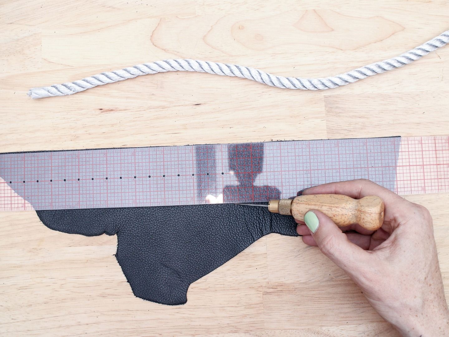

To create a round strap or handle, first decide how long you want it to be. Cut a section of your rope core this length, then measure the circumference of the rope with a tape measure, in my case it is 1 1/8".
Trace a rectangular outline onto leather 1 1/8" wide and about 4 inches longer than the rope on each side for the strap ends). Cut out the strap, leaving 1/2" seam allowance on each long side. Punch sewing holes along the side lines starting 3 1/4" in from each end.

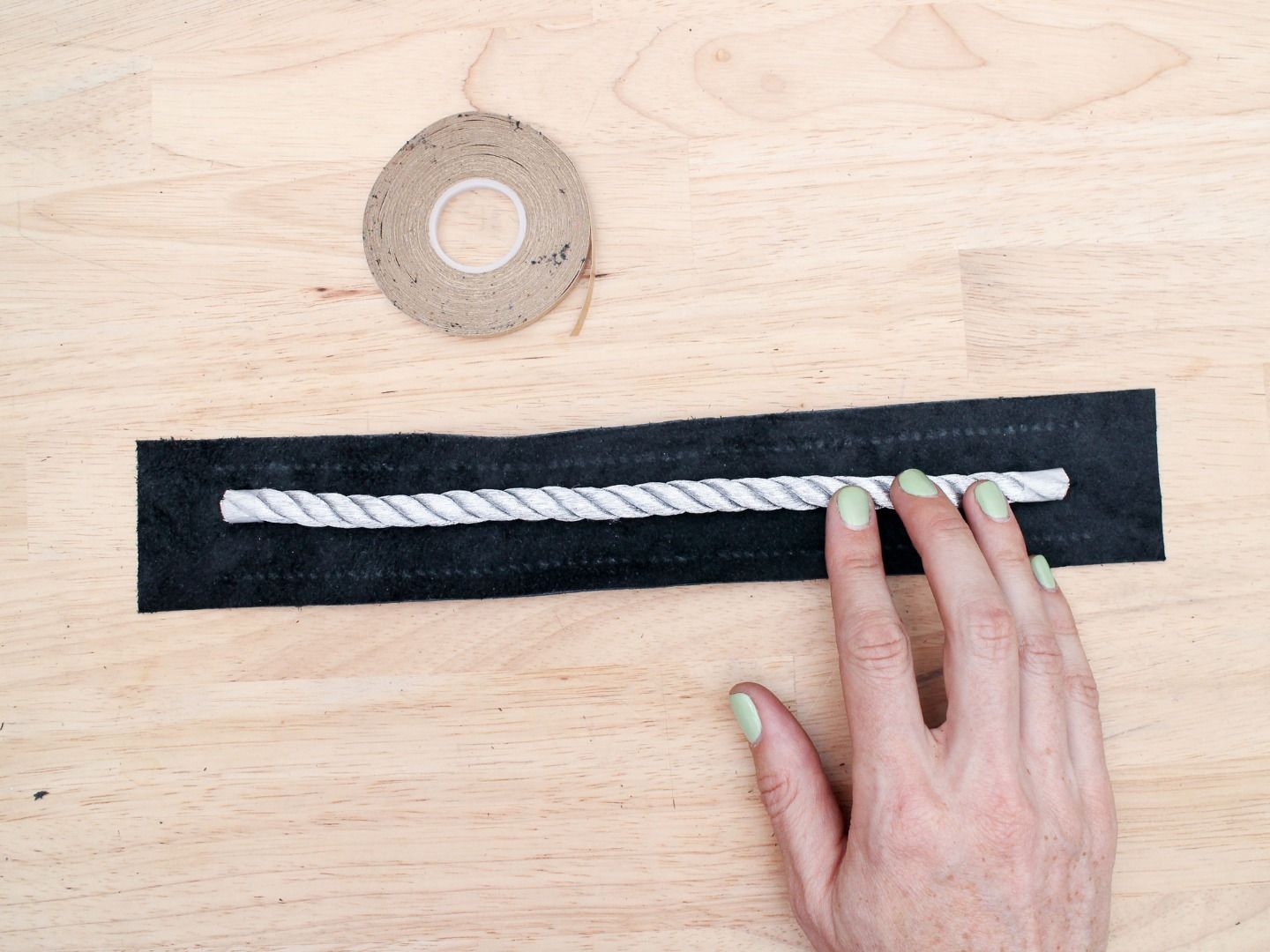

Use some double sided tape to stick your rope core down the center of the strip on the flesh side.
Now take a needle and thread and sew the leather together around the rope using a saddle stitch.
When you've finished stitching, trim the edge of the seam, leaving a 1/8" - 1/4" seam allowance.
Shape the ends to your liking, keeping in mind how you plan to attach them. You could leave them straight and rivet them around the rings of a bag, or if you wanted to sew them directly to the bag, you might give them more of a diamond shape like this, and then punch sewing holes through them and the bag.

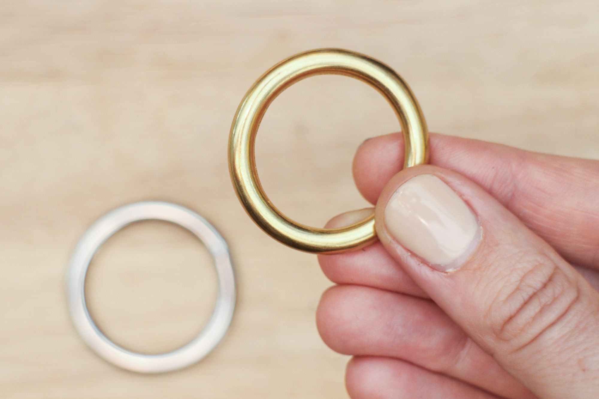

I used a large O ring in the back of the harness to connect my 4 straps, looping them around the ring and riveting them. I used snaps on the other ends of the straps so they could be looped around the D rings of the small bags to attach them.
