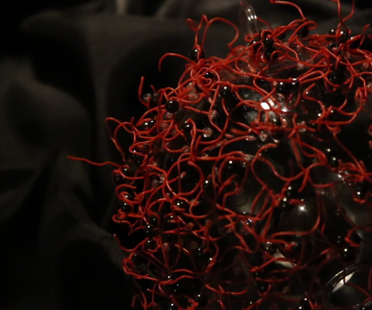

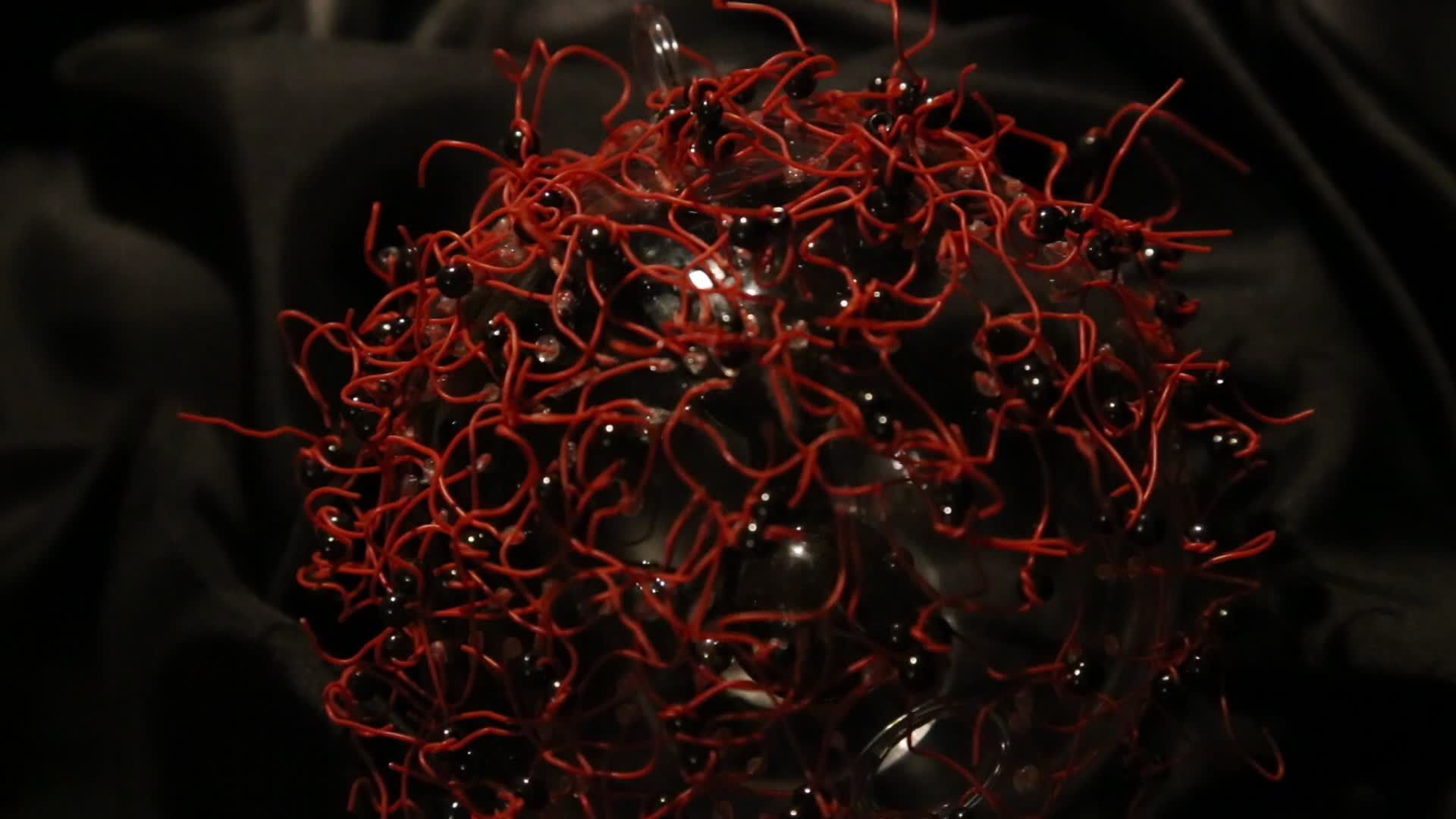

At MakerFaire 2015 and the Oakland Aeolian Day, many people inquired about how I built my Acousto-kinetic sculpture called "Chatty Spring Ballz". The motion characteristics needed for this sculpture required long "wiggly" style extension springs. It's nearly impossible to find long industrial springs that have a lower overall spring tension that would support the kind of mechanical "jiggle" and "wobble" I wanted to display, so I was forced to make my own.
While there is already a fine Instructable on how to create small springs using a hand-held chorded drill and short wire segments, this method would not work well for very longs springs, very wide springs, or if you lack sufficient strength to both hold up a drill press and maintain consistent wire tension around the mandrel, all while simultaneously preventing music wire from tangling on itself or catching on the box. ...So I chose to make my springs on a lathe. And this Instructable will show you how you can too.
