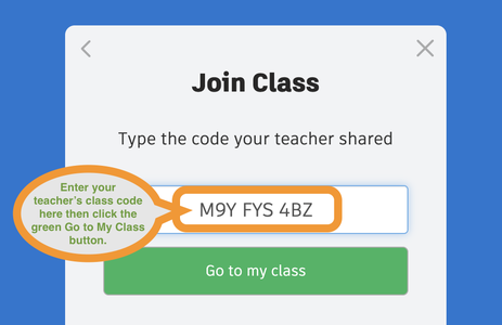

  2. Login with Students Join a Class green button.
  3. Enter your teacher's class code (see below) then green Go to My Class button!
