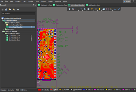

Step 2: Export Gerber File From Board Layout
Well, the first step is pretty obvious, you will need some board design that you gonna put on a PCB.
I use Altium Designer to create board schematics and layouts, but it really doesn't matter what you use, because they should all have gerber file export for board manufacturing.
There's of course many different ways from layout to production, but since this instructable is focusing on the production method, i'm gonna stick to the one i use.

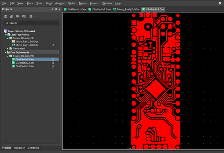

So first thing is to export your layout to a gerber file. Make sure you consistently use the same system of measurement your machine uses for exporting and importing files (in my case, its the metric system / mm).
For this tutorial i only export the top layer isolation routing of the Arduino Pro Micro as an example.

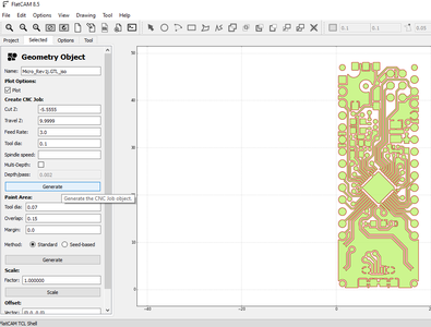

To create the G-Code for Snapmaker, i use FlatCam Freeware (flatcam.org). It is intended to create G-Code for CNC milling so we have to do some small changes to make it work with the Snapmaker Laser Module. But let's create general G-Code first:
1. Import the Gerber File into FlatCam
2. Select the File in the "Project" section and switch to the "Selected" section
3. Insert values as stated in the 2nd picture. Tool diameter is 0.1 and one pass. You can ignore everything below because we only do the Isolation Routing now. I will later get into why i use only one pass.
4. After the Isolation Routing is generated, go back to the "Project" section and select it.
5. Back to the "Selected" section, put "-5.5555" for "Cut Z" and "9.9999" for "Travel Z", so we can easily identify every occurrence of those values later in the G-Code. You can just ignore the "Feed Rate" and press "Generate" to generate the CNC job
6. Back to the "Project" section, select the generated CNC job. Switch to the "Selected" section again and press "Export G-Code". You will be asked to save your G-Code File somewhere. Save it with ".nc" extension

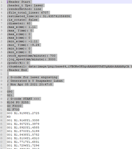

Ok now we edit the G-Code file generated by FlatCam. So open it in your favorite text editor. All you need is a decent "Search & Replace (all)" feature.
1. Open G-Code file in a text editor
2. Copy the metadata from the top of a Snapmaker Luban created G-Code file and the first lines of G-Code (like shown in the picture). The important settings here are the Jogspeed and Workspeed, I found that Jogspeed 3000mm/min (g-code "G0 F3000)" and Workspeed 700mm/min (g-code "G1 F700") work perfect for me. The other line ("M106 P0 S255") turns on the internal fan of the laser module at full speed, so we just leave it.
3. Now we need our values set for "Cut-Z" and "Travel-Z" in FlatCam in the previous step. Those values tell the CNC machine to raise or lower the toolhead and therefore cut or just travel without cutting. But since we use the laser module, we don't change the Z-axis at all but rather turn the laser on and off.
So we replace all occurrences of the line "G01 Z-5.5555" with the line "M3", so instead of lowering on the z-axis we turn the laser on.
Then we replace all occurrences of the line "G00 Z9.9999" with the line "M5", so instead of raising on the z-axis we turn the laser off.
4. We replace the bottom lines of the file as shown in the pictures. For some reason FlatCam generates the "G00 Z9.9999" two times. I just replace it with one M5 to turn off the laser. Afterwards we go home and turn off the laser modules fan. Then the Snapmaker metadata comment again...
5. I don't know if it is necessary, but since FlatCam generates no spaces in between the X and Y coordinates but Snapmaker Luban does, i replace all "Y" with " Y". Notice the starting space. So the coordinates will look like "X1.234 Y1.234" instead of "X1.234Y1.234".
I don't know if you need to do this, but i didn't want to find out the hard way and let the machine just laser around uncontrolled.... so better just do it (=
6. Voila! You're pretty much ready for laser engraving your layout to the prepared board. I suggest you double check your G-Code file for any mistakes just to make sure. You can also run it through a CNC simulation program like CAMotics to see if it is really doing what you want.

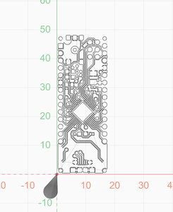

Now you can import your G-Code file into the Snapmaker Luban Software. You can check if everything looks alright, see what dimensions it will have and where the tool starting point is. This data you need for setting your working coordinates, because with the method i use here THE RUN BOUNDARY CHECK WILL NOT WORK AND GIVE WRONG RESULTS. Make sure you read the section about adjusting the g-code to understand why!!
If everything looks good, send the file to your Snapmaker. Start the job, ignore the wrong preview image and time (if you followed my guide) and set the working coordinates and focus manually.
