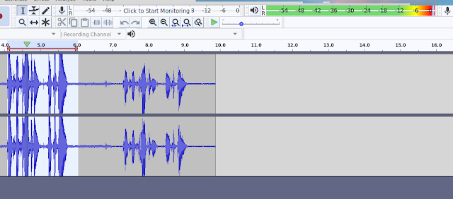

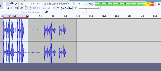

make sure that the level meters are not spending much time in the red section, -6Db upwards
Ideally re-record but if that is not possible limit the damage by highlighting all of the clip 'ctrl +a' and select Effects, Amplify and reduce the volume until it is not clipping and just edging into the red occasionally.

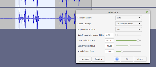

Background noise removal.
If you can see the level meters twitching when you are not talking then you have background noise and it is easily removed. Listen on headphones and turn them up a bit, here it now? Download the Nyquist Noise Gate from https://wiki.audacityteam.org/w/images/7/75/Noisegate.ny.
Adjust the gate threshold and click preview until you only hear silence when not talking, set gate frequencies above 250hz to eliminate other noise. Takes some experimenting but well worth it.

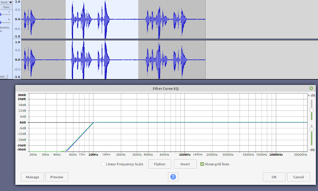

Next, try recording "Peter Piper picked a pickled pepper" and see how many times your mic makes a popping noise. Click effects, filter curve, we can roll off frequencies under 100 or 250Hz as they play no part in speech other than to be annoying. Test a few settings until you get the result that you want. Highlight a short sample to test then try with the full recording before committing to save.
Save your project so that you can work with the original audio again and export your result as a .ogg file which is lossless (so as not to degrade it further in processing) and easily imported into KdenLive.

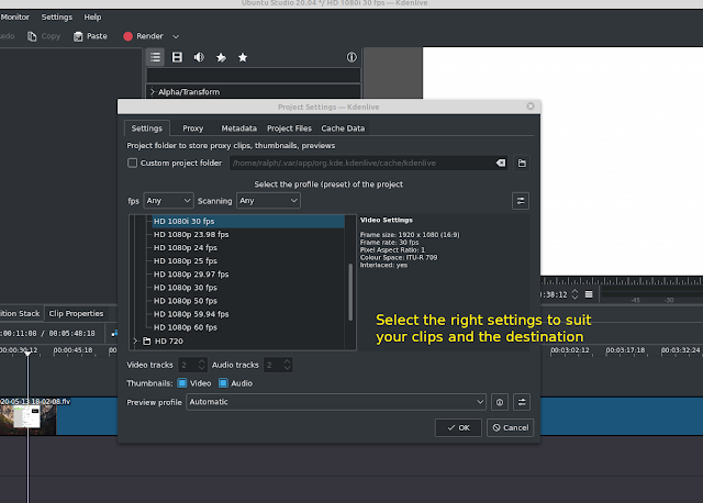

Click Project, Settings and set the video format the the appropriate one, 1080p 25 FPS in mp4 format is ideal for YouTube. Don't use 4K if you do not have a 4K video camera, it is pointless and generates massive files which will take hours to render. Also Youtube's compression reduces quality too.
Import your clips one at a time as they take a few seconds to import. Save the project as soon as possible to preserve the setup. If you are importing 4K clips or have a slower PC then setup proxy clips so you can preview everything in 720p without taxing your machine, the final render will be in the projects selected mode.

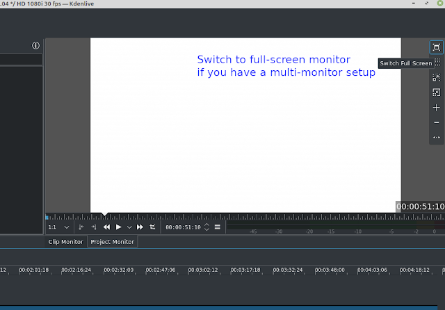

If you have more than one monitor take advantage of the full-screen monitor mode. Much easier to work with and preview the render.
