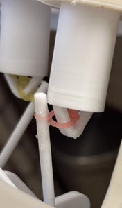

Step 7: Connect It With Rubber Bands
Now comes the somewhat tedious part. Before I explain, I would like to clarify that in the end, rubber bands for both connections were used, and while there were some other alternatives, arguably better, from a cost and aesthetic standpoint, rubber bands did the job.
To connect the connecting rod to each part c in the crankshaft, first pass the rubber band through the small hole, and tie a big knot around the part c. You can then tighten, double knot, and cut off the edges. Do this for all 8.
To connect the pistons to the connecting rod, first tie a knot and place it around the top of the part c. Tighten, glue it to part c, then use the ends of the rubber band to wrap around the piston and tie a knot, then double knot, then cut off the edges. Again, do this a for all 8.
The results for all connections are shown above.
