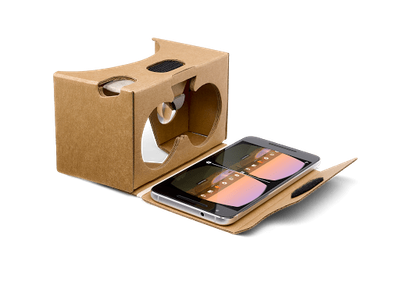

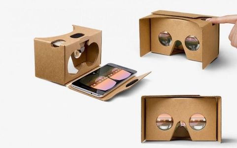

  1. Simple Design: Made from cardboard, it includes lenses, a slot for a smartphone, and an input method (like a magnet or button).
  2. Smartphone Integration: Users slide their smartphone into the front of the Cardboard, and the phone’s screen serves as the display.
  3. Lens Function: The lenses in the Cardboard split the phone’s screen into two images, creating a stereoscopic (3D) effect when viewed through the lenses.

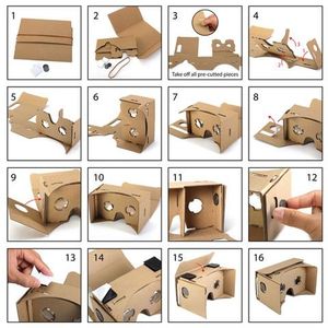

Step 1:
Instructions:

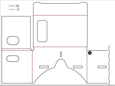

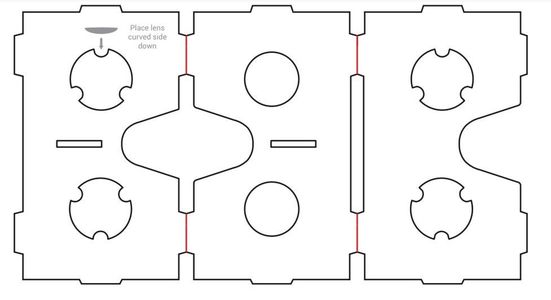

  1. Download and Print the Template:
  • provides a template for Cardboard. Download and print it out.
  1. Cut the Cardboard:
  • Place the template on your cardboard.
  • Use a craft knife to cut out the Cardboard shape following the template lines.
  1. Fold and Glue:
  • Fold the cardboard along the lines indicated in the template.
  • Glue the flaps where necessary to hold the shape.
  1. Install the Lenses:
  • Insert the biconvex lenses in the two eye slots.
  • Make sure the curved sides face outward.
  1. Add the Magnets:
  • Place the neodymium magnet inside the box on the side.
  • Attach the ceramic magnet on the outside of the box to hold the neodymium magnet in place. These will act as your input button.
  1. Add Velcro and Rubber Band:
  • Attach Velcro to the flap where your phone will sit to secure it.
  • Place a rubber band around the entire box to further secure the phone.
  1. Attach the NFC Tag (Optional):
  • Stick the NFC tag inside the Cardboard if you want to auto-launch a VR app when you insert your phone.
  1. Assemble the Viewer:
  • Fold the Cardboard into its final shape as a VR viewer.
  • Make sure everything is firmly glued and dried.
  1. Insert Your Phone and Test:
  • Slide your smartphone into the Cardboard holder.
  • Open a VR app or a 360° video and look through the lenses.
