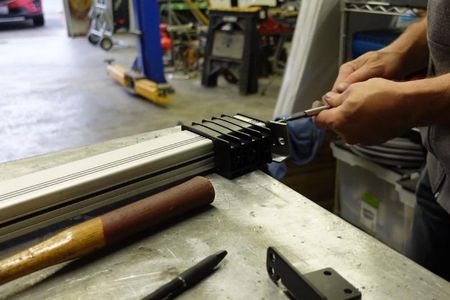

Step 2: Making Prototype Mounting Bracket

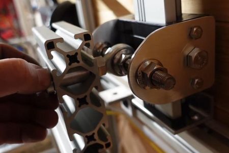

Chad begins building some brackets for the track actuators so that they can mount to the 80/20 aluminum frame on the bottom of his LMTV camper. Since the original bottom brackets of our PA-18 actuators were meant for wall mounts, Chad will be replacing them with the custom brackets he made later in the project. These will be custom brackets that are suitable for mounting to his 80/20 aluminum frame.

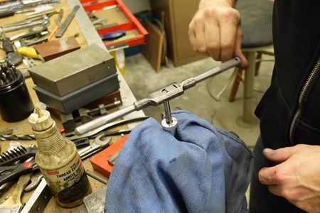

Choosing a chunk of angle aluminum that is roughly the same thickness and depth as the original bracket piece gives Chad the required offset to hold his actuators away from the LMTV camper wall so that its track can cycle. He then proceeds to cut a wider chunk of aluminum, taps the required holes, and drills through the tapped holes. Once completing the prototype bottom bracket, Chad secures them to a PA-18 actuator and installs mounting screws so that they will lock into the 80/20 aluminum frame.

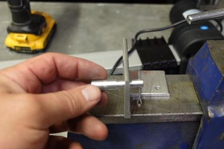

He then proceeds with the making of upper brackets. An aluminum rod is milled down to the size that will go through the upper bracket. Unlike a bolt system, this project will enable for a pin system to make the installation possible in the given space constraints of the LMTV camper which does not have enough room above the setup to fit a wrench.
Step 3: Making Brackets for the Actuators
After successfully making the prototype mounting bracket, Chad proceeds with making the bottom brackets with thicker material. Doing so allows for Chad to make a slight recess to countersink the heads of his screws so they will be flush against 80/20 aluminum frame and still have room for his bolts.
By using the same tools and a similar build process, Chad cuts his upper brackets into shape for the actuators to mount in the ceiling. He also made some pins that he can place through the upper brackets with cotter pin inserts. This pin system will make installation with needle nose pliers possible later in the build.

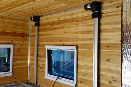

Step 4: Installing the Actuators

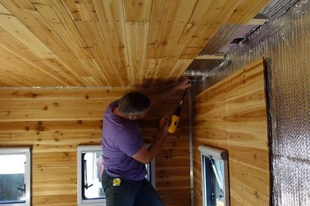

Chad places his mounting brackets and actuators against the walls of the LMTV camper to determine where he will need to drill pilot holes. He then drills pilot holes into the 2x2 steel at the top of his truck and uses a 90-degree bit with self-tapping screws to bite into these pilot holes.
Once all his mounting brackets are secured using the self-tapping screws, Chad proceeds with mounting the four PA-18 custom actuators to the brackets. He had previously cut a spacer hole at the top to get access to the 2x2 steel up in the ceiling for mounting the upper portion of his track actuators. Each actuator is mounted with one pin at the top and two bolts at the bottom.

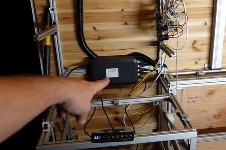

Chad cuts the wires of his PA-18 actuators to shorten their length and later adds his own Molex connectors to the wire ends. This is to make the process of swapping the PA-18 actuators easier in case a unit were to become faulty and require future replacement. Chad then wires the four actuators to our FLTCON-4 control box and RT-11 remote which keeps the actuators moving at the same speed together. Since the actuators were customized with 24VDC motors, they were compatible with the FLTCON-4 control box.

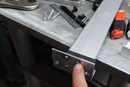

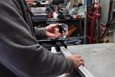

Step 7: Making Brackets for the Track Pieces

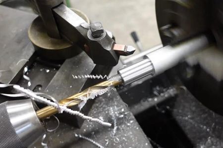

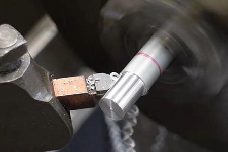

Welding coupons were used to stamp out the brackets that go on the track pieces of the four track actuators. Chad uses our PA-18 datasheet as a reference during the making of his bed frame mounting brackets. A 1-inch bar stock was later milled down to the required dimensions for his pins. For the best accuracy possible, Chad uses a digital caliper to measure the diameter of his pin each time he pauses between the milling process.
After adding cutting lube, Chad proceeds to cutting out the inner treads for his pin. A vice is used to secure the pin as he manually makes the treads. A 14-millimeter thread pattern was used so that it will match the back of his Heim joints. He also uses a knurling tool to make a pattern around his custom pin so that it has better grip.

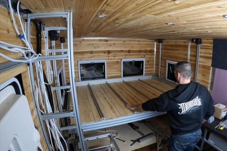

Step 8: Building the Bed Platform and Frame

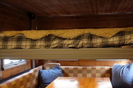

Aluminum channels were then used as the sides of the bed rails which were later attached to the mounting brackets of the bed frame. Planks of tongue and groove cedar were pre-stained and cut into shape. Each plank was then numbered in the order that they will be placed onto the bed platform. This allows the bed frame to have an appearance which matches the screw patterns of the LMTV camper’s roof.

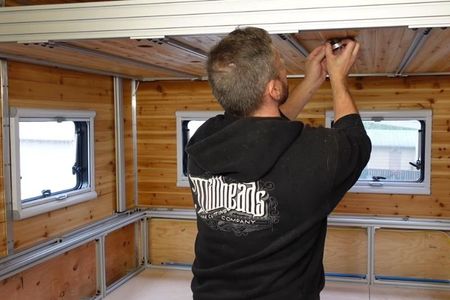

Step 9: Installing Light Fixtures

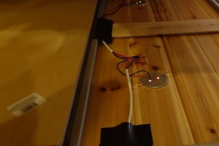

Chad then measures out the bed platform and carefully determine where he will place his light fixtures. These light fixtures are going to be for his other build project of a Dinette Table below the bed lift. After confirming where he will place his lights, Chad drills four holes below the bed platform and mounts his lighting fixtures.
Step 10: Wiring the Light Fixtures
After installing all the lights, Chad wires them together in a parallel circuit and then places a layer of plywood on the top of the bed frame to support the weight of his mattress and cover his wiring. To keep the electrical wiring of the light fixtures tidy, a weight or a spring can be used to pull the cable down into the LMTV camper’s cabinet when the bed raises up. As the bed lowers down, the cable will be fed out from the weight of the bed.

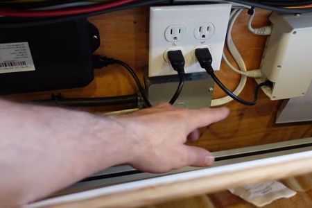

The control boxes of his bed lift system are mounted with screws to the wall at the back of his dinette area. The control box is connected to the AC power supply of the LMTV camper. For added safety, a plywood cover is used to keep the wiring away from the seats and cushions. The controllers for both the bed lift system and table lift are located next to the Dinette Table for convenient access.
