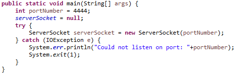

Step 1: Setup a ServerSocket in the Server Class
Create a static Server socket at the beginning of main in the ChatServer class and instantiate it with a port number.
TIP: ServerSockets may be instantiated with a port number other than 4444, but numbers lower than 1000 are more likely to already be in use by the system.
