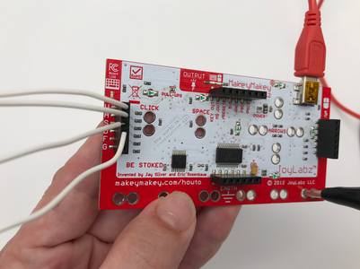

If you want to make a program that works with the key presses WASDFG, flip your Makey Makey over and use the small white jumper wires to attach to your alligator clips and the conductive spots on your guitar. (Picture 1)

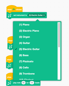

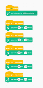

With this option, you'll want to use the "set instrument" block at the start of the game. (Picture 2)
There are 21 instruments to choose from in Scratch and instrument 5 is an electric guitar. Add the "set instrument" block to the "When flag clicked" block to set your sprite to an electric sound! (Picture 2 and 3)

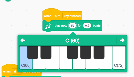

If you want the guitar notes to play when you press WASDFG, you will add a "when __ key pressed" for each note you want to program in your workspace. Attach a "play note __ for __ beats" to each key press block. (Picture 3)
To change each note, click into the play note variable and a keyboard will pop up like in picture 4. Choose the key note you would like to program. Use the arrow keys to adjust the octave. (Picture 4)

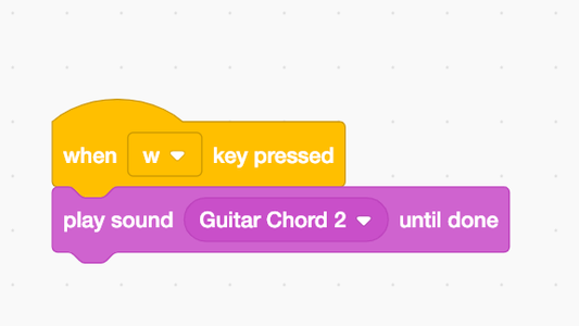

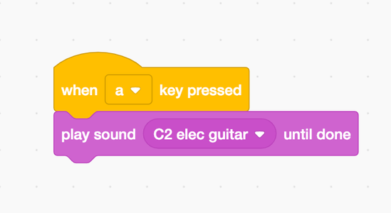

To program your keys, just drag a "when __ key pressed" for each note you want to program into your workspace and attach a "play sound __ until done" to each "When __ key pressed." (Picture 3)

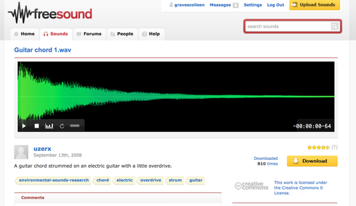

"Free Sound" has a good bank of guitar chords you can download for your games. Some files will upload to Scratch, but some won't. Download the mp3 or wav files from the website. (Picture 1)

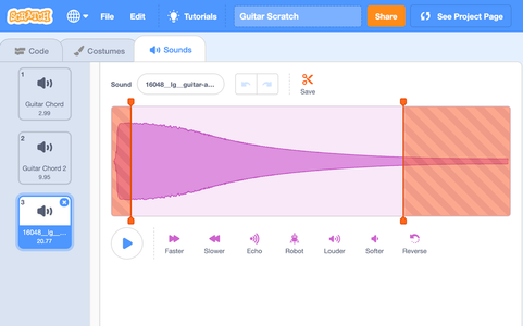

Once the sound is uploaded, you may want to edit the sounds as needed. You can shorten sounds by clicking on "trim" and adjusting the red areas to trim what you do not want. You can also adjust the full sound clip with these "effects": faster, slower, echo, robot, louder, softer, reverse. (Picture 3)

You can use the arrow keys and/or WASDFG! If you use the back of the Makey Makey, be sure to use your white jumper wires to plug into the left black header on your board (picture 3).

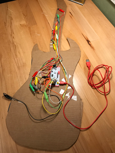

There are lots of great examples of Makey Makey guitars in the world! My daughter and I made these examples just for this guide. My heavy metal guitar is a more advanced build, while her ukulele is a great build for beginners!

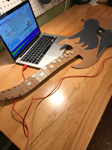

Picture 1: Front of my Heavy Metal guitar with 11 inputs (Programmed in SoundPlant.)
Picture 2: Back of my Heavy Metal guitar (I wrapped conductive tape from the dimes on the front to the back so I could plug my alligator clips on the back of my guitar. I also used the tape that was on my Amazon box for earth- did you know the black tape on an Amazon box is conductive? Cool, right?) I used regular tape to hold all the wires in place.

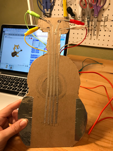

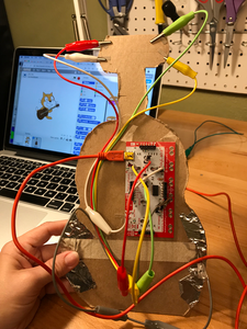

Picture 3: My 9 YO's 4 string Ukulele (Programmed in Scratch.)
Picture 4: Back of my 9 YO's Ukulele (My daughter made her guitar with HVAC tape for earth and conductive fabric tape as the strings of the guitar.)
