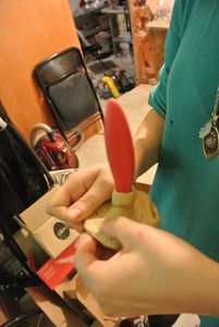

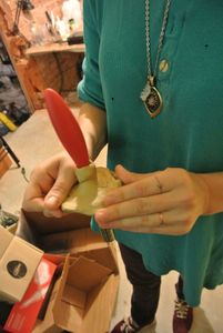

Begin by taking your desired object which you will be using as your primary vibrator shape. We used a smooth hard plastic handle from a screw driver. You will then begin to make a sprue. To make your sprue:
  • Take a basic brown modeling clay to sculpt around the base of your object. Make sure that the modeling clay has a smooth and seamless connection to the object (the handle in the case of a screw driver)
  • Make the sprue's circumference significantly larger than the handle's shape. (This is to avoid future difficulties when using the finished vibrator, such as it accidentally getting stuck or caught.)
  • Smooth out areas of the clay to ensure that the vibrator will have a smooth exterior skin.
  • Continue to use modeling clay to make a large handle, completely covering the remaining parts of the object. This clay handle will be used to mount onto the table.

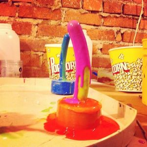

Gather three cups and the disposable popsicle sticks. Add Dragon Skin Silicone Part A to first cup, about 3/4 of the way. Add Dragon Skin Part B to second cup, about 3/4 of the way.In third cup, mix 1:1 ratio of Part A and Part B – use half of Part A’s cup and half of Part B’s cup. Add selected color of paint to third cup’s mixture, about a pinky nail size drop. Mix evenly with the popsicle stick to prepare your silicone pour.
Step 4: Pouring Mixture 1 of Dragon Skin
With your Mixture 1 of Dragon Skin Silicone, begin to pour evenly at the tip (top) of your object. Make sure to cover the entire surface area of your object, including your sprue and base. You may use your popsicle stick to gently guide the silicone, as gravity pulls the silicone down the shaft of your object, creating a pancake at the base of your mounted figure. Make sure to double check that there are no thin layers. Specifically evaluate the tip of the structure, adding more silicone as needed. After covering the entire object, you will then need to set you timer for 10 minutes which will allow your first layer of silicone to cure. You may then use your handheld dryer shortly to harden this first layer, watch out for bubbles!
Step 5: Preparing Mixture 2 of Dragon Skin
With the remaining portions of your Part A & Part B Dragon Skin Silicone, mix the two together evenly. Next, select your second color to add to Mixture 2. You should add approximately a pinky nail size of a drop. Mix evenly with your popsicle stick to prepare your second layer silicone pour.
We use this second color to make sure that we have completely covered our object’s area evenly. If you see that your first color can easily be seen, and is not covered with the second layer, make sure to cover those areas before proceeding. Again, make sure to double check that there are no thin layers. Specifically evaluate the tip of the structure, adding more silicone as needed. You will then need to allow your second layer of silicone to cure. You may then use your handheld dryer shortly to harden the second layer, watch out for bubbles!
We let this glove cure overnight before proceeding to the next step. Realistically it only needs 1.5-2 hours to cure though.
