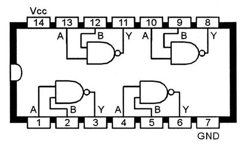

The 74LS00 is a quad 2-input NAND gate IC, which means it contains four separate NAND gates, each with two inputs and one output. In this project, we'll guide you through creating a simple logic gate simulator using 74LS00 NAND gates, which can be a useful educational tool for understanding digital logic circuits.

Step 1: Connect Power Supply
Connect the 5V power supply to the VCC (pin 14) and GND (pin 7) pins of the 74LS00 IC.
Step 2: Add LEDs for Outputs
Connect an LED and a 220Ω resistor in series to each of the outputs (Y) of the NAND gates (pins 3, 4, 10, and 11).
Step 3: Add Push Buttons for Inputs
  • Connect a push button between one input (A or B) of each NAND gate and ground (GND).
  • Connect another push button between the other input (A or B) of each NAND gate and ground (GND).
Step 4: Connect Unused Inputs
Connect the unused inputs of each NAND gate to VCC to prevent floating inputs.
