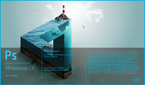

Step 1: Open Adobe Photoshop
Adobe Photoshop CC 2015 is what we used in our screenshots. Photoshop is preferred because of its ability to remove background (white) layers for your Geofilter. Any photo editing software with the ability to edit layers is also acceptable.

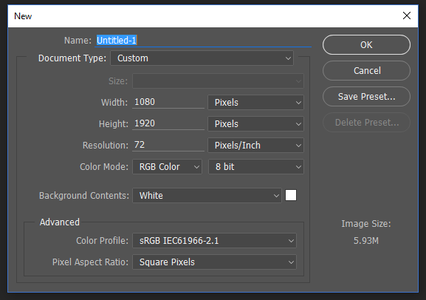

Step 2: Create Canvas
Go to top left drop down bars and select File > New.
A pop-up will then appear. Change the photo units to pixels and the width to 1080px for width and 1920px for height. Press OK when you are done.

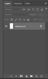

Press the “Layer Visibility” icon in the Layers tab on the bottom right part of Photoshop. It is the icon that looks like an eye.
Step 5: Finish Modifications
Make any other modifications to your image as you please. Make sure to save your work.
Your final image should have a checkered pattern in the background indicating a lack of a colored background as shown in the screenshot.
