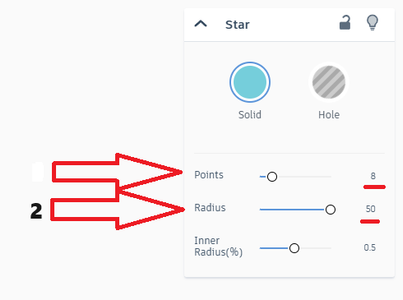

- Adjust the Points and Radius in the Star’s Properties window.
- Points: The default is 5 – with a max of 30. Using an even number of points will make it easier to add holes to the design. For these instructions set the Points to “8”. Note: The rotation degree the outer points are at are 0, 45, 90, and 135. The rotation inter points are at 22.5, 67.5, 112.5, and 157.5.
- Radius: The default radius is 20 which creates a 40mm (or 1.57 inch) Star. For these instructions set the Radius to the maximum value of 50 for a 100 mm (or 3.94 inch) Star.
- Inner Radius (%) leave it at 0.5.

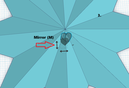

- Use the Mirror (M) function to flip the heart shape horizontally.
- Use the Align (L) function to center the Heart Shape to the exact middle of the Star.
- Move the Heart Shape 1.5mm down from the center towards the lower point of the Star shape.
