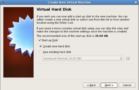

Step 6: Creating a Virtual Hard Disk
The next available page should be as seen above. Here you will be given the option to create a hard disk for the virtual machine. The program will then prompt you to choose between three options but VDI should be your best option between the three. Next it will have you choose between fixed and dynamically allocated and you should always choose dynamically allocated as fixed will create problems for you in the future when you start reaching system limits. Once this is selected it will prompt you with a slider to choose the amount of storage that will be allocated to the vm with a slider and the location it will be downloaded to. After you make your disk allocation click the next button to progress.
*This will allocate a certain amount of disk space to the vm for its boot. It is recommended to create a new disk with an allocated twenty-five gb of space as instructed. If you have an existing disk that you would like to use instead follow the prompts and select a disk available on your pc.
*Most of these settings can be changed if need be in the future so feel free to be loose with your choices. Here you can choose the amount you want to allocate but it would be smart to allocate the recommended amount unless you want to create a bigger more complex VM.

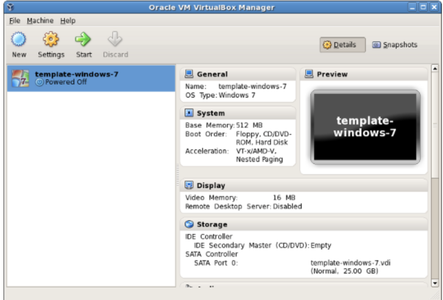

Step 7: VM Manager Main Page
Upon clicking next, your virtual machine should be created and visible in the opening page. There it will display all the statistics of the machine in the panel to its left. Because the virtual machine was only formatted for windows you still need to download a OS that you chose to the machine from a preloaded save file. Remember that OS that I had you download from the beginning? That's what is going to be allocated to your virtual machine.
*Included are the name you allocated and the operating system, the allocated memory and the boot sequence, the allocated video memory and the status of the remote desktop, the information regarding the storage method, and the information regarding the network status as well as a few other bits of information about the system that don't yet matter.

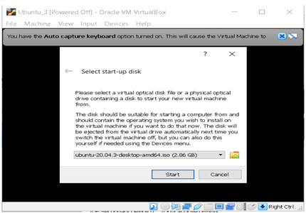

Step 8: Adding OS to Your Virtual Machine
Upon starting your machine, you should be greeted by this page which will have a drop down menu. Once you see it, click the small folder next to it and it will give you the option to add a file to it. Select this and you’ll have to go to the location you downloaded the OS to and select it for use. After you select the OS image, select start to image it to the VM.
Once you click start the OS should go through a linux boot sequence. Wait until it prompts you next. The moment you start to use your mouse and keyboard you will be given the option to capture the inputs from your device. Select this as it will allow you to use these to control the VM in the future.
*It should also give you a key command to disconnect the vm if you are having trouble exiting it as the keystrokes are being used as controls in the vm. Make sure to remember this or you run the risk of being stuck in a vm. Usually the command is the right CTRL key.

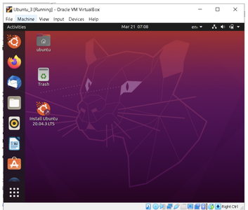

Step 9: Select Kali Linux
After this select graphical install of kali linux from the small list of options and the program should begin imaging.
Your next pop up should be the system formatting and this will be unique to every OS. Follow the prompts and that should bring you to the home screen of your VM and you should be set thereafter. You have now officially set up your own virtual machine and it should be ready for use!
