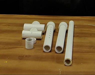

  • PVC Pipe - 3/4"" x 18"
  • PVC Pipe - 1/2" x 18"
  • PVC Fittings - 2 end caps, 2 T-joints
  • Drill Machine
  • PVC Cutter
Step 1: Design
  • To start with, we took an 18" long pipe of 3/4" width and cut in 2 equal halves.
Step 2: Create Water Outlets
  • To create the water outlets, drills of 2mm were made.
  • The holes were made in equal number on each side and in a straight line and with equal spacing.
Step 3: Apply End Cap
  • After the holes were made, clean the holes, so that no PVC residue is left.
  • Put the end caps on.
  • Use PVC sealant too secure the end caps.
Step 4: DIY Stopper
  • To make the DIY bearing, a stopper needs to be fixed.
  • So to make the stopper, a 1/2" L-joint is taken. A rim is cut from the edge.
  • A cut-piece of 3/4" pipe of about 1" length is also taken.
Step 5: Fittings
  • Next the 1/2" pipe is taken and one side is heated and slightly tapped too make slightly fat. This step is important as this will secure the 3/4" pipe of 1" doesn't come out easily from this end.
  • Then the 3/4" pipe of 1" is inserted through the 1/2" pipe and passed to the fat end.
  • Followed by the 1/2" rim. This rim will act as a stopper in the neck. So this rim has to be glued and fixed.
  • The 3/4" pipe of 1" will easily revolve on the 1/2" pipe, which will be supported by the rim below.
