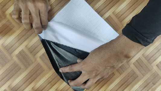

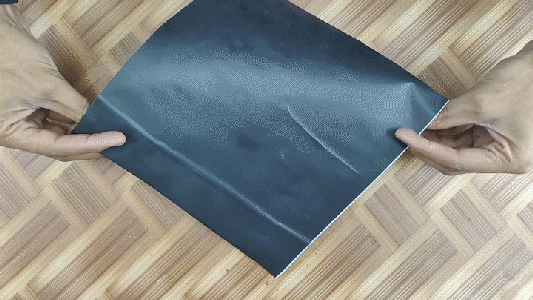

Step 1: Preparing the Vinyl
- used four 7" x 7" vinyl self-adhesive sheets.
- started by peeling it off.

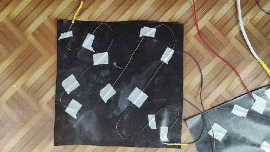

Step 2: Preparing the Heating Pads
- Nichrome wires are laid on both vinyl pads on the sticky side of the vinyl.
Step 3: Preparing the USB Cable
- Cut the host end of the USB cable and slit the wire ends.
Step 4: Powering the Heat Pads
- Connect the power cord (USB) and secure the connection with a heat-shrink tube.
- I covered the vinyl with another piece of vinyl.
