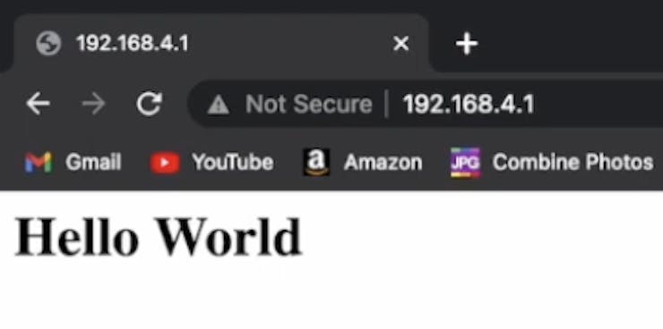

This code essentially sets up a device to act as an Access Point, allowing clients to connect to it. When a client connects, it receives a simple "Hello World" HTML page as a response.

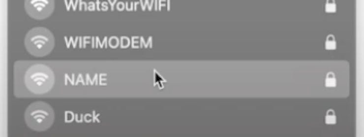

In order to connect to the network simply go to the WiFi on your device (Computer or Phone) and find the network. If the code runs and the network can’t be found just simply Power Cycle the Pico W by turning it off and leaving it off for 10 seconds, then rerun the code. In this case, I see the following WiFi network.

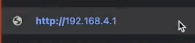

On a web browser, I go to the HTTP webpage as follows. Just use any web browser. Your IP address for your Pico W will be different; you can get it from the console in the code provided.
The result:
