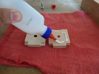

Step 3:
Already having pieces of wood, began to drill them with a drill of 6.5 mm for transpazar the piece and use a sword to drill the screw head is inside the piece of wood.
In my case for my camera screw that fits its base is 1/4 standard hex head rope so will press from the bottom with a 11mm die.

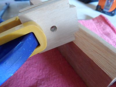

Then will stick two pieces of wood as shown in the photos and let dry.
Step 4: Test and Assembly.
Once the wood pieces are dry, we can put the screw from the bottom and screw our camera to the base.
