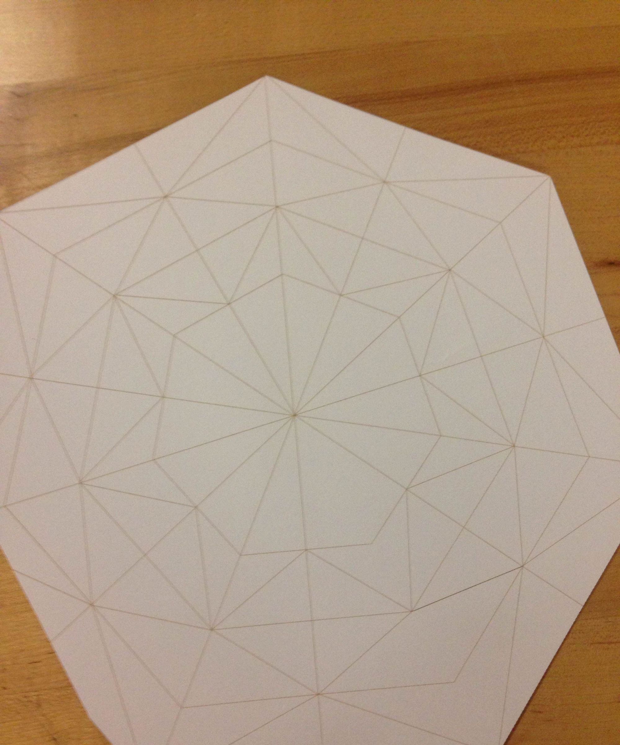

Step 4: Painting
The fun part about this is that you can make what ever designs you want to be lit up.
With the simple use of tape you can cut out designs, tape it to the plexi, paint over it, and then take it off. After the paint drys you have a back lit design. The paint also helps reflect light around a little bit more and makes the edge of the plexi really pop with color.
