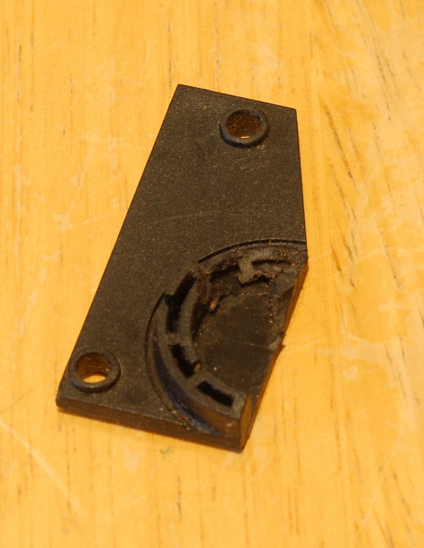

Step 2: Measuring the Part
The first photo shows the broken part. The damage might not look too bad in this photo, but in practice it leaves the joiner fence loose and wobbly. The tool is unusable as is.
The first step was to get a pair of calipers and take all the measurements I could.

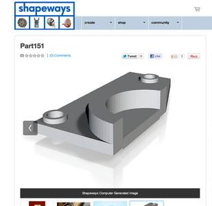

Step 4: Generate and Upload .stl File
AutoDesk Inventor can generate an stl file, which is the format used by most CAM software. Not having my own 3-d printer, I uploaded it to Shapeways.com. Shapeways allows you to print an object in a variety of materials, ranging from plain white plastic to stainless steel. I opted for the plastic since it's the cheapest.
The stl file is included here. The model is available at the AutoDesk 123D gallery. You can also access the project directly at Shapeways, and order your own copy shortly.

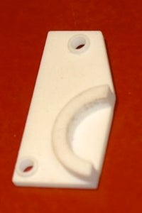

Step 5: The Finished Part

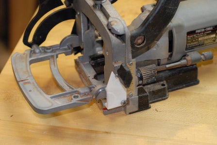

Two weeks later, this arrived in the mail.
Step 6: The Part Is Installed
The piece was a perfect fit. I had expected to need to make refinements on my prototype, but the very first version fit the joiner perfectly right out of the box.
