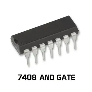

Introduction: Creating an AND Gate Circuit Using 7408 IC
The 7408 IC, also known as a quad 2-input AND gate, is a versatile integrated circuit widely used in digital electronics. In this project, we'll explore how to create a simple AND gate circuit using the 7408 IC. AND gates are fundamental building blocks in digital logic circuits, making them essential for various applications, from simple hobbyist projects to complex digital systems.

Step 1: Prepare the Breadboard
  • Place the 7408 IC on the breadboard, ensuring that each pin has its designated space.
  • Connect the VCC (Pin 14) to the positive rail and GND (Pin 7) to the ground rail.
Step 2: Connect Inputs
  • Connect input A (Pin 1) and input B (Pin 2) to separate switches or push buttons.
  • Connect the other side of the switches to the positive rail.
Step 3: Add Pull-Down Resistors
  • Connect a 10kΩ resistor from input A (Pin 1) to the ground rail.
  • Connect another 10kΩ resistor from input B (Pin 2) to the ground rail.
Step 4: Connect Output
  • Connect the output (Pin 3) to an LED through a 220Ω resistor.
  • Connect the other end of the LED to the ground rail.
Step 5: Power Supply
  • Connect the positive terminal of the power supply to the positive rail.
  • Connect the negative terminal of the power supply to the ground rail.
Step 6: Test the Circuit
  • Press the switches or buttons for inputs A and B.
  • Observe the LED, which should light up only when both inputs are HIGH (1).
