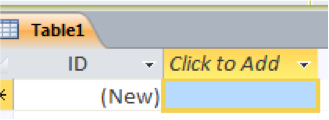

Step 3: Creating a Field
A field holds individual pieces of information within the table.
1. Click on the drop down arrow in the “Click to Add” box above the table.
2. Select the desired field type.
a. For an address book, most fields will be text fields.
3. Click within the grey box to ensure it is selected. Type a field name into the highlighted placeholder.
a. In the Name and Address table, enter “First Name,” “Last Name,” “Street Address,” “City,” “State,” “Zip Code,” and “Apt Number” as the fields.
b. In the Email table, enter “First Name,” “Last Name,” “Primary Personal Email,” “Secondary Personal Email,” and “Work Email.”
4. In the Phone Number table, enter “First Name” and “Last Name,” then use the “Quick Start” option of “Phone.”
a. To utilize the “Quick Start” option, click on “Fields” on the Navigation Ribbon.
b. Click More Fields in the “Add & Delete” section.
c. Scroll down in the drop down list to the “Quick Start” options.
d. Click “Phone.”

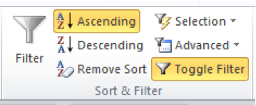

Step 6: Sorting Records Alphabetically
1. Click the heading of the column to be sorted on the table.
2. Select the “Home” tab on the Navigation Ribbon.
3. Under Sort & Filter, select either “Ascending” to sort from A to Z or “Descending” to sort from Z to A.
a. These are located next to the picture of the funnel with the word “Filter” under it.
b. Other ways of sorting include “Equals,” “Does not equal,” “Contains,” etc., but they are not necessary for our purposes.
Step 7: Filtering Records
1. Click the drop down arrow in the field to be filtered.
2. Uncheck all unwanted items.
3. Click “OK”.
4. To remove a filter, click the “Toggle Filter” button in the Home tab under Sort & Filter.
a. The “Toggle Filter” button is on the bottom right side of the section.
3. Click “OK”.

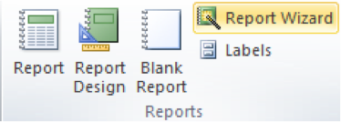

Step 9: Creating a Report
Reports are similar to queries in viewing information from several tables in one place. The report is much more professional and formal and can be designed and used as a print out.
1. Select a table from the Navigation Bar on the left side of the screen.
2. Go to the “Create” tab on the navigation ribbon at the top of the screen.
3. Click “Report Wizard” under the “Reports” Section.
4. Select the desired table to draw from in the drop down list.
5. Select the field to draw from in the available fields box on the left.
6. Click the “>” button.
7. Repeat with each desired field.
8. Click “Next.”
9. Choose any desired grouping levels.
i. This will simply change the order in which the information will appear.
a. Select the field of highest priority.
b. Click the right arrow on the screen after selecting the field to be prioritized.
c. To create levels of lower priority, repeat steps a and b.
10. Click “Next.”
11. To sort the records, select up to four fields.
a. Select each field by using the drop down arrow.
12. Choose either “ascending” or “descending” order to sort the fields.
13. Click “Next.”

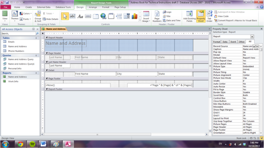

Step 11: Creating a Report Header
1. Right click the report made in the previous section in the sidebar labeled All Access Objects, under.
2. Click “Design View”.
3. Double click the “Last Name” field under the Page Header bar.
4. Type your last name into the field.
5. Repeat steps 4 and 5 with other fields such as “First Name”, as needed.
