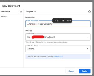

Step 3: Save and Deploy the Script:
  1. Click on Deploy > New Deployment.
  2. Select Web app.
  3. Set Anyone with the link as the access level.
  4. Copy the Web app URL and use it in the Arduino code.
