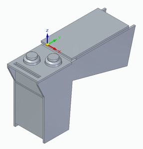

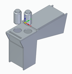

Step 4: 3D Modeling
Option 1:
Materials: Computer
Sketching the center console was not enough for me. With a limited amount of MDF board, I had to make sure I got enough. Therefore, I designed every part of the center console and then assembled them in CAD.

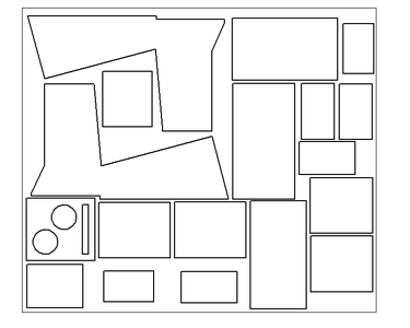

Step 6: Insert Parts Into Drawing
Since I have a limited amount of MDF, I have to make sure that I have enough to make all my parts. To do this, I created a drawing in SolidEdge that same size as my MDF board and inserted all of my parts onto it. By orienting the parts a certain way, I had just barely enough MDF to cram all my parts on it.
Step 7: Drawing on MDF
Materials: MDF Board, Pencil/Pen, Ruler
Now that I have confirmed that all parts fit, I drew them on the MDF.

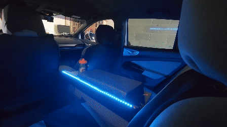

Step 25: Ambient Lighting
Since the car oddly comes with ambient lighting as standard but not rear cupholders, I thought integrating some ambient lighting with the center console would complete the final look. I want the ambient lighting to only turn on when it gets dark enough to be seen. There are 2 options with powering the light. Each has their own pros and cons.
Option 1: Use an external power bank
Pros: Simpler to make
Cons: Have to replace the battery every so often
Option 2: Use the car's power
Pros: Never worry about charging the batteries
Cons: You have to run wires throughout the vehicle
I decided to go for Option 2 because changing the batteries would be a hassle. I would also be using this chance to get the LEDs to light up the inner storage compartment of the center console.

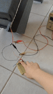

Step 27: Designing the Circuitry
This is quite the simple step. The analog pin would read the photoresistor value. The program (Step #30) would see which part of the program is true for that photoresistor value. The digital pin would send that program to the LED strip's data line so it can preform it. The 5 volt power supply is connected to the 5V line of the LED strip. The ground is connected to both the Arduino's GND and LED's GND.

4th piece: Rear Compartment Lighting (7 LEDs)
I measured out the length of wires needed to route throughout the console and soldered them together.
Tip: Make sure that you follow the mini black arrows on the LED strip (2nd image). The data only goes in that direction. If you input the data against the LED's arrows, it won't turn on.
Step 29: Installing the LED Strip
Materials: Double Sided Tape, LED Strip, Drill, Wires, Solder
I used double sided tape to tape onto the side of the console. To make the wires flow neatly, I drilled some holes to feed the wire throughout the console.

Step 32: Soldering Everything
Materials: Perf Board, Solder, Wires, ATTiny 85
I transferred all my components onto a perf board and soldered them on. I then retested to make sure everything works. (Image attached...don't mind the mess of random wires. I just used them for a stable connection)

Step 35: Issue...
It turns out that the output of the USB C ports that I planned on using in the car required some sort of confirmation before it sends out 5 volts. Since I don't have that "confirmation", the vehicle stubbornly refuses to give me the juicy 5 volts I needed. It instead gave me a pathetic 0.7 volts which is nowhere near enough to power the ATTiny 85 (Needs between 1.8V to 5.5V).
Step 36: Problem Resolved
Luckily, I discovered a sneaky 12 volt socket in the trunk of the car and a very long 12 volt car charger. You might be wondering, wait..12V>>>5.5V wouldn't it burn out the ATTiny 85? First, yes. Second, after closer inspection on the 12 volt car charger, it said that it converts the input of 12V to 5V which is EXACTLY what I needed. After snipping the cable, I was overcome with joy when I saw two very simple wires: black and white. No Data Wires!!!
Step 37: More Soldering/Desoldering
Oh boy... take two. I desoldered the USB C cable and solder the new cable in.
White: Positive
Black: Negative
Step 38: Testing
MUAHAHAHAHAHAHA after plugging it in, IT FINALLY WORKS!!!!!!! Oh... also means I ruined a perfectly good USB C cable...

Step 43: Video: Testing the Photoresistor
1st Video: When the interior got bright enough, the LEDs would automatically turn off
2nd Video: When the interior got dark enough, the LEDs would automatically turn on
