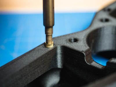

Step 2: Place the Threaded Inserts
Using the soldering iron, maybe with an old tip, heat up the brass inserts and place them into the holes.
Be careful or you will melt the PLA all the way through.

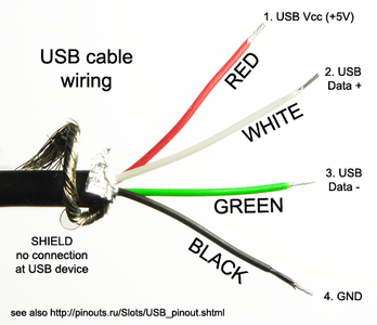

Step 3: USB Wiring
To have only one USB cable to access all functions I used a USB hub.
This way I can have Space Mouse, Console and 2 extra ports in one. It also helps if, like me, your laptop only has one USB port.
With Photoshop for example I can connect a mouse and a grafic tablet with one cable only.
To do this, I desoldered two of the USB sockets on the hub and connected two micro USB cable.
USB is a standard and your cables should always have the same colours.

Once you have all your components wired up, you can place and bolt all parts together.
Be careful not to tighten up the bolts too much or you will make the M2 inserts loose.
