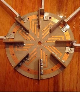

The LED "bars" harvested from the scanners, are actually "light" pipes with a small RGB LED at one end. This allows the entire bar to illuminate. The main challenge was to figure out how to attach them to a central "hub" and wire them back to the controller. Due to the geometry of the LEDs and in order for the light to face forward with respect to the hub, the pins had to be at 90 degrees from the flat surface of the hub. Therefore, I settled on a main circular PCB that serves as the hub along with eight vertical "fins" that would attach to the hub. But since the fins must both be mechanically and electrically connected to the hub, how would I accomplish that? After some thought and imagining, I settled on the following:
  1. Epoxying the fins vertically to the board.
  2. Creating traces that line up between the hub and the fins. Then join them at the intersection with solder "fillets". The solder fillets also have the advantage of providing additional mechanical strength to the bonding of the fins with the hub.

My design utilized a radial trace near the periphery of the hub that serves as the power rail. This rail provides the common (+5 volts) to all 8 LEDs. Each fin connects to a single 4 pin LED (common power + R + G + B). The traces on the fins align to the common power rail along with separate traces for each RGB channel. These channels radiate longitudinally across the board and terminate on pads which will connect to the cabling that will eventually be routed through the curtain rod and back to the base electronics.
When preparing your pattern, pay special attention to which side of the board you want it to appear on. You may need to make a mirror image of your pattern depending upon which side of the board the traces are to appear. Also, any readable text must be mirrored if it is to appear correctly on the bottom side of the board. For this project, my traces appear on the top of the board and I forgot to consider that initially so my first attempt failed. Fortunately, I was able to turn "lemons into lemonade" by using that board as my hub "backing board".
Finally, I drew some mounting holes. The holes on the outer edge are for standoffs to connect the circuit board to the identically sized backing board. The central hole was used as a guide for an adjustable circle cutter which I would later use to cut out the board.

Once the hub and fins were ready, I glued each fin radially using a small amount of epoxy resin glue on the edge of each fin. In order to ensure that each fin is perpendicular to the hub, I placed a small square metal bar adjacent to the fin in order to align it while the glue dried.
Finally, I soldered four solder "fillets" which electrically and mechanically bond each fin to the hub. I then used a multi-meter to verify electrical connectivity between the hub and the fins in order to assure that no adjacent traces were shorted together.

In my case, the pins of some of the LEDs are in a bit of a zig-zag arrangement (see picture). I knew that, but didn't think that would be a problem, especially if the mounting holes I drilled were large enough. It turned out later that these would not fit flush with the PCB. There was not enough pad area to drill larger holes for them to pass through, and since I had already fabricated the board with all of the fins attached, I had to come up with a workaround. I ended up cutting some "shims" from pieces of 1/8" thick lucite and drilling 1/16" holes in them. These were sufficient to be placed over the "zig-zag" area leaving the straight part of the pins exiting on the other side. It works. You might ask "why not just straighten the pins with some needle nose pliers?". Well the wire is very rigid and this is a sensitive part which can easily detach, so I didn't think that was an effective solution. If I had to do it over again, I would simply make the pad areas on the fins larger in order to accommodate 1/16" holes. The disadvantage of doing that is that the PCB would not make a rigid connection with the pins, it would rely on the solder joint only. That may be OK, and I did have rigidity issues anyway.
Since rigidity of the light bars was another problem I had to solve it. I solved it by fabricating some metal tabs to help support the LEDS and soldering them in, along with some strategic use of superglue. I did this in a way so as to be "reversible". In other words, if I ever needed to replace an LED, it should be possible to do so without ruining anything other than the bad LED itself. It's still a bit fragile with these long light pipes emanating from the star, but it is rigid enough to remain intact with reasonable care while working on it. Eventually, it will sit undisturbed on a plant shelf, but I will need to be very careful in the mean time!
