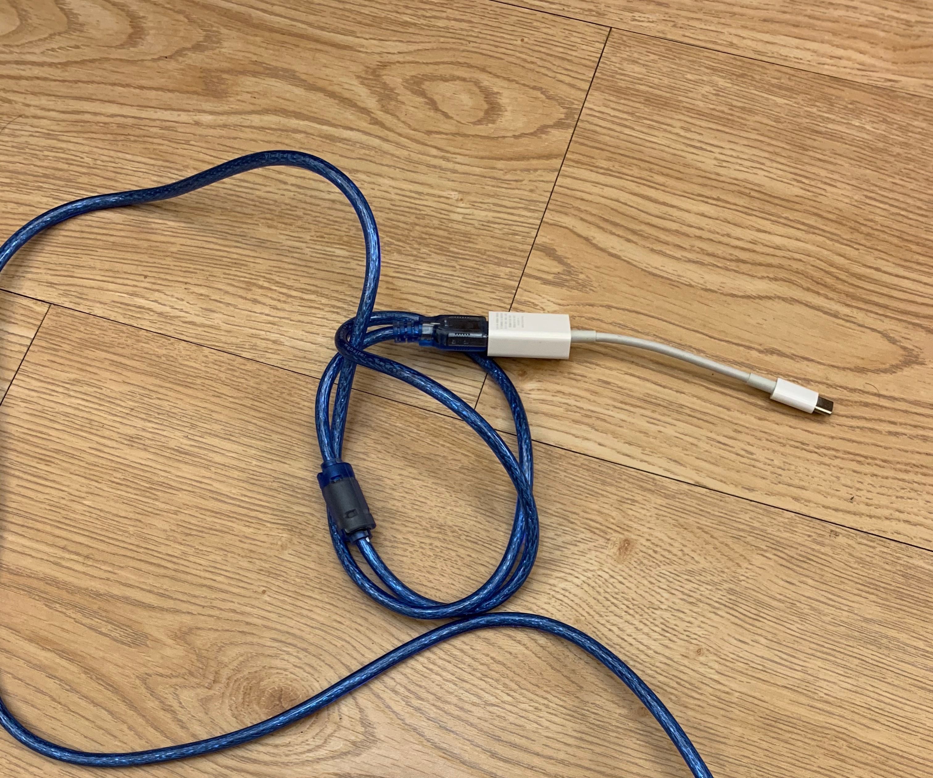

Because the wires connected to the speaker can't directly connect it to the board, so we will be needing extending wires. The red one connected to the speaker is the positive one, so therefore, we need to connect it to the D-pin. The black wire is the negative one, so therefore, we need to connect it to GND.
