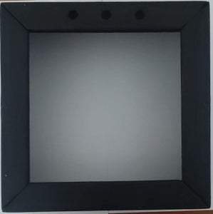

    Step 3: Making the Box
    First of all, a 21.5x21.5 cm wooden box that will house all the design components has been built . We will have to leave an opening to the outside of 16x16cm, which will be where we house the methacrylate and the LED screen.
    Some holes will have to be made to place the different components. As you can see, there are 3 holes in the front of the box that will house 3 microphones. This is due to a change in the design, since in the final work only one microphone is useful so it is enough to make one of these holes not three.
    It will also be necessary to make holes to get the whire that feeds the system out of the box, 10 mm in diameter, another to put the switch of 18x12mm , another hole for the buzzer so that the beep can be heard better. The measurement of that hole will be the diameter of the buzzer used and finally another one to be able to manipulate the potentiometer that will allow us to change the brightness of the screen.

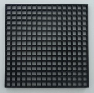

    Step 4: Making the Grid
    A 16.2x16.2 mm layout has been designed. In some cases, it is necessary to scale the measurements before printing, because the design may come out smaller than the actual size.
    The .stl file is attached with the design so you can repeat the printing at your home.
    This mesh will be placed between the methacrylate and the LED screen to create a better pixel effect. This way the colors will not mix with each other so we achive a nice effect.
