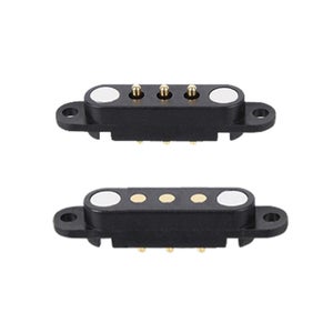

  3. 3-Pin 2.54mm Pogo Pin Magnetic Connector (2 pair set)
  4. 8x1.5mm Neodymium Magnet (8 pcs.)

The pogo pins used in the project are winged and I obtained them from a local store, I created the design accordingly. But I have also added STEP extension files in case you want to make changes, so you can update the design as you wish.

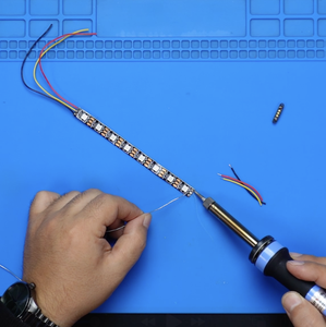

Prepare the LED Strips:
Remove the LED strips for the right and left sides of the main box. Solder three wires to the DIN (Data In) and DO (Data Out) terminals for each strip. These wires need to be longer to reach the bottom and sides of the main box.
  1. LED starting point (DIN) will be the bottom side (this is the side where the circuit board is located)
  2. The LED endpoint (DO) will be the top side. From this side, it will be connected to the Pogo pins on the right-left side of the box with wire.
Connect the wires to the Pogo Pins:
Once the wires are soldered to the LED strips, connect the wires coming from the DO terminal of the LED strips to the pins on the pogo connectors respectively. Use heat shrink tubing to insulate the soldered connections and prevent accidental contact between the wires.
Insert the LED Strips and Pogo Pins:
Insert the pogo pin connectors into the designated slots on the right and left sides of the main box. Secure the LED strips starting from the DO terminal (top of the main box) and insert them along the edges towards the DIN terminal (bottom).
With the pogo pins and LED strips in place, the main box assembly is now complete. The pogo pins are ready to transmit power and signals to the side boxes.
In the next step, we will install the pogo pin connectors for the right and left boxes to complete the modular system.
Each side box is equipped with a 22-LED strip. Start by soldering male pogo pins to the DIN (Data In) terminal of the LED strip. Ensure that the pin order matches the female pogo pins in the main box. This alignment is critical for proper signal and power transfer.
  1. The DO (Data Out) terminal of the LED strip is left unused in these boxes.
