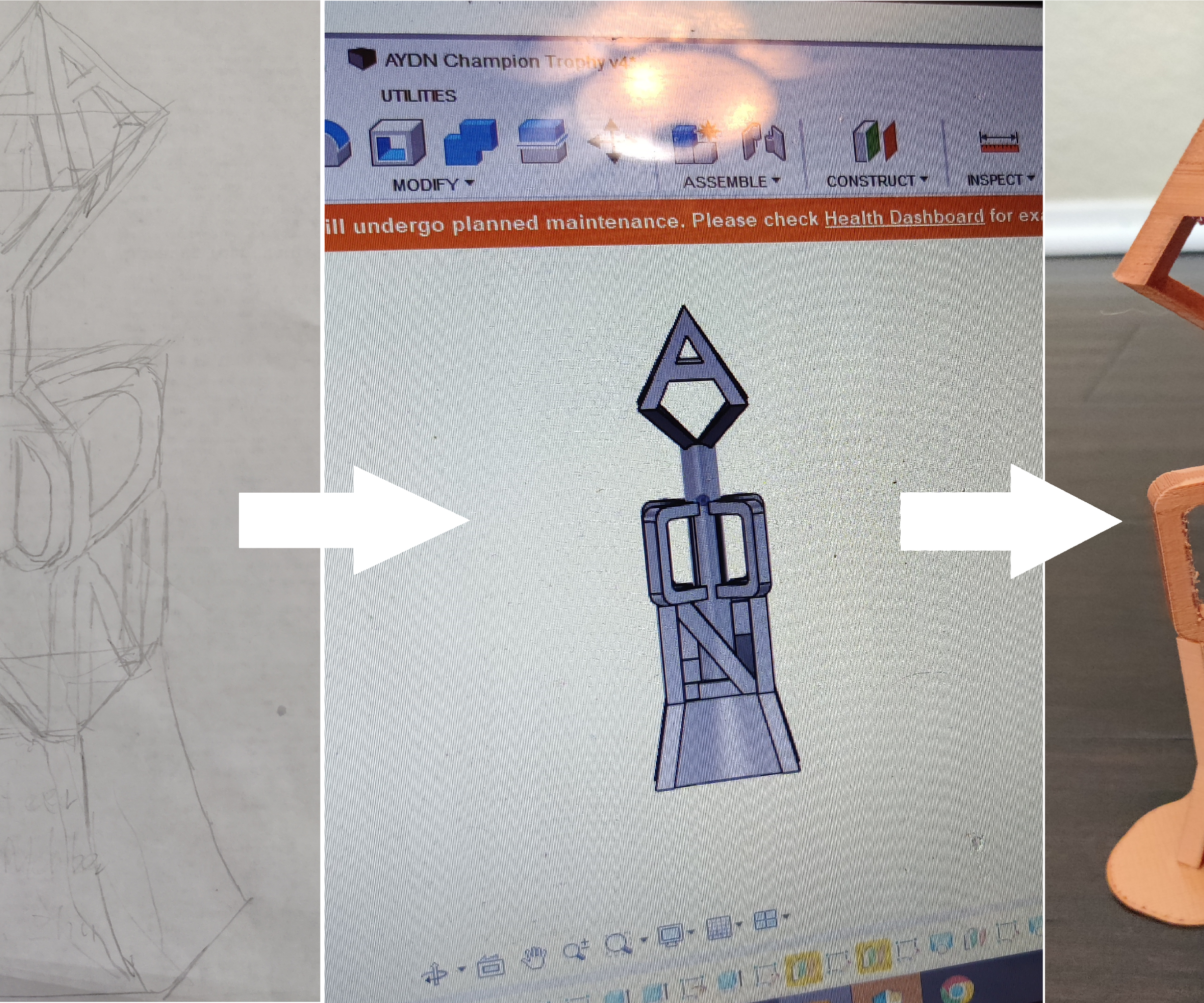

I want to design a fun trophy that does not merely etch AYDN letters on the body of the trophy, Instead, AYDN letters will be an integral part of the 3D structure of the trophy. Several different designs had been created, with different arrangements of the 3D letters. For example, in the early version of the design, all four letters are of the same size and dimension, i.e. each is a cube. The final design places an enlarged letter Y right in the middle, resembling a tree shape to symbolize the growth of the youth.
As a side project, I apply the similar concept to design a medal for their soccer club. The four letters of AYDN nicely form a soccer player image.

Step 1: Conceptualize With a Paper Sketch Model
To brainstorm and conceptualize the 3D model, I made a paper sketch model first.
Step 2: Create CAD Model
I used Fusion 360 as the CAD tool. The design history is captured in the video. Attached is the STL file.

Full size build require approximately 24-hr printing time. Test run with a half size build first, which requires 5.5-hr printing time. The half-size, full-size, and the early failed prints are shown in the figure.
